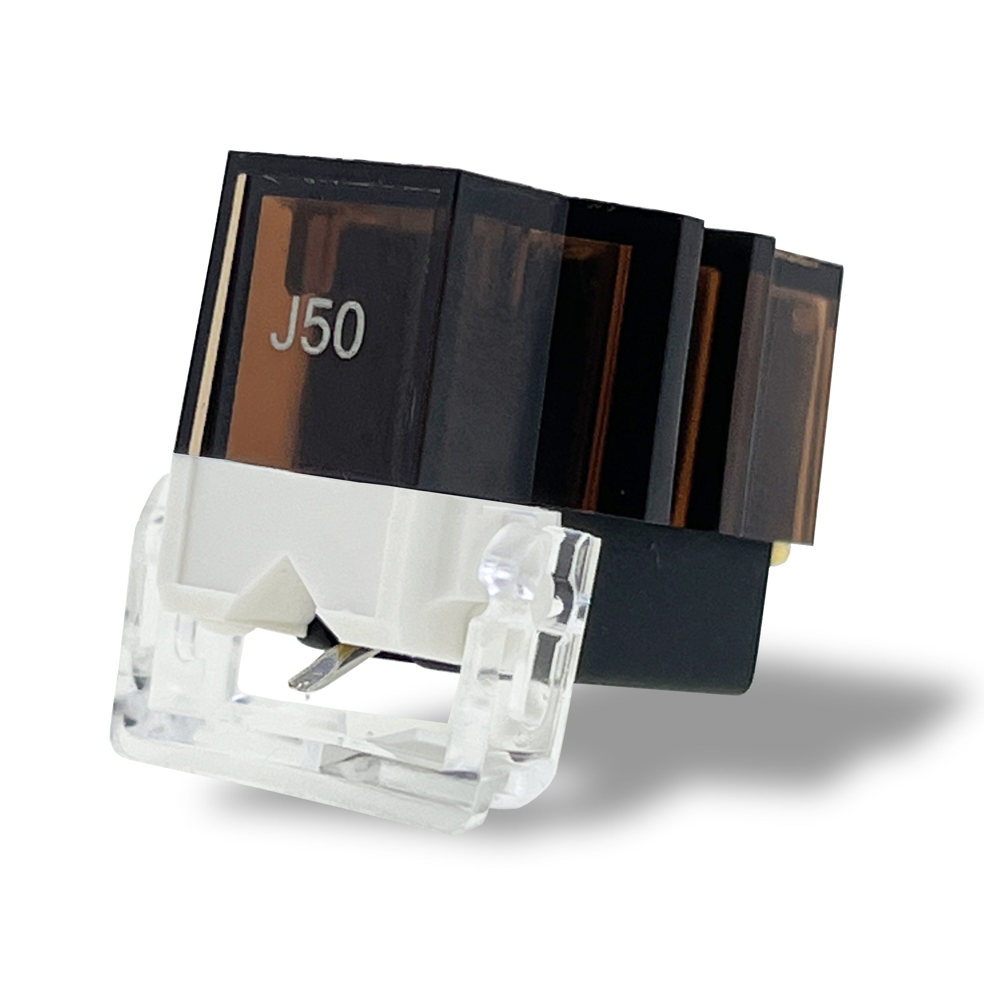

Short arm with very little friction and no anti-skate. You need a cartridge with a tough cantilever. I have seen delicate cantilevers get skewed by the inward skating force. A Shure M3D or M7D would be a great match. That vintage cartridge has become pricey, but al least JICO makes a good replacement needle.
The N44G is the "hifi" variation for the M44, the -7 is for DJs. But you can surely listen with both needles in hifi quality. The main difference is in the compliance and tracking force that the needles require.

The M91ED is a great cartridge but the output it too low for my taste. My go-to cartridge for vintage tube amps is a Shure M44-7 which is no longer produced but JICO has picked up the slack and now manufacture their own version of the M44.
