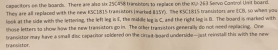

Hi Legrace, thanks again .. just a note that recap kit from ebay seller did include 6 transistor typically needed for speed issue and instructions worries me that more elusive ICs may be the implication.
Hope to find some assignable cause/fix when my DP-80 is stripped again to check the recap/transistor replacement assuming it was working fine as claimed when the Japanese seller sold it to me.
Cheers.
Yes I saw the kit included replacement transistors and the one included in the kit is a common replacement. For problem you report this is simply where I would look first for installation fault.
I think this was mentioned but check the install of the transistors first. When I replaced some I had to pay close attention to the pin layout. Some replacements have a different pin layout.
Hey Mark, Tks .. will certainly do so. The original 2SC458 are replaced by KSC1815 and ebay seller did emphasized the care to look at marking on the pcb to follow suit.
Cheers.
Hey Legrace, good news ! It was all the 6 replacement KSC1815 transistors being installed in the wrong direction as it was reversed of stock ones. Running fine and regain 0.1% and back to 100% confidence on dealing with Japanese seller of used items as it nearly dropped to 99.9% .. lol ! Tks again for the responses .. with appreciation. Cheers.
Hey Mark, You hit 6 nails and bingo .. lol ! Just to say, my pcba has all the transistors in same directions .. hence all in wrong orientations but glad no permanent damage I think .. so far :) Tks again and cheers.
