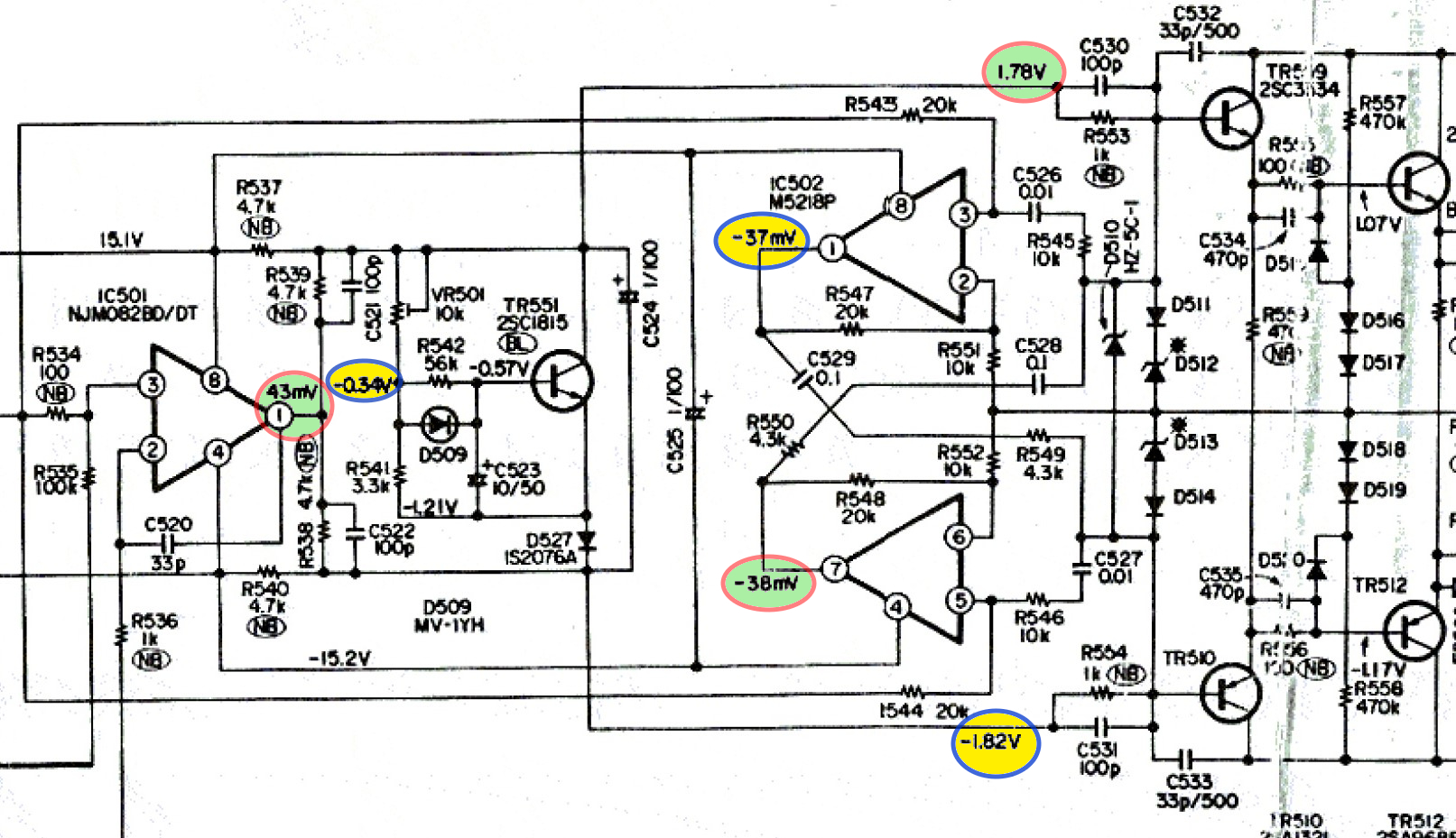

A couple of days before I went on vacation I turned on the 2nd amp for the first time, on the DBT. The light bulb went dim right away. The idle current did not rise and the adjuster had no effect. There was +3.5v at pin one of IC501 instead of +43mV. I have seen this movie before so I turned off the amp and went on vacation.
At this point I have checked every transistor, diode, and electrolytic capacitor for proper installation and type/value. No discrepancies noted. I still have to recheck the ceramic caps and resistors.
Right now I am inspecting the board for poor solder connections and solder bridges. I think that since nearly every single component on the board is new we can guess that I made a mistake somewhere and will have to slog through each and every last part and connection and find it.

@Bratwurst7s
Could you (later) confirm if these DC voltages are all correct, with the DBT off?
