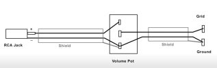

I am a little confused about the earth and signal ground connection. I thought that you were supposed to tie the RCA ground braid to the input tube ground point and not connect it to the RCA connection point (Leave it floating at the RCA end)
Can you clarify how you implement this properly?
This is what I am following when time to wire the volue pot:

This is what I am following when time to wire the volume pot:
I think that's fine. Since you have a ground wire tying the RCA connector common and the volume pot common together to only the input tube ground domain, it does not really matter if you connect both ends of the shield or not. The hum will be prevented because you used proper grounding- insulated the RCA connector from the chassis, so you are not allowing a ground loop that would tie chassis ground, and input tube ground together through the shield, so there is no pathway for current to flow through the shield if those two grounds have noise between them. Not connecting the shield at one end was typically a poor substitute for proper grounding.
You know, most people do not understand the purpose of the shield. In most people's imagination, the shield is somehow armor, preventing noise from penetrating the shield and getting to the center conductor. Actually the opposite is true- A coaxial arrangement with center conductor and outer shield are purposely capacitively coupled together, through the dielectric of the cable. At audio frequencies, the intent is that =every bit= of noise that is coupled into the shield is intentionally also coupled equally to the center conductor, such that the noise will be common to both conductors, and the receiver, which will respond only to the difference between the conductors, will reject the "common mode" noise. This strategy is most effective if you are using a true differential amplifier, but the principle is the same here.
