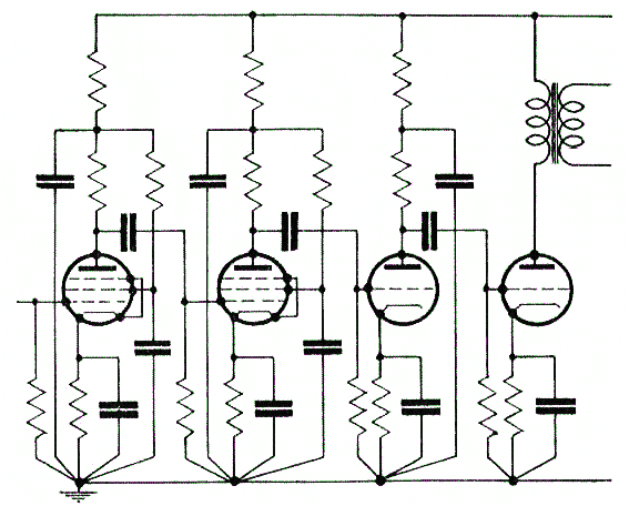

OK, hum problem fixed. What I did during the original rebuild process was to connect the ground-lead secondaries of the PT, filament ground and high-voltage ground leads to the chassis. The original build had them connected to the ground bus wire that runs the length of the chassis. When I disconnected these grounds and temporarily connected them with a patch cable to the ground bus the hum became inaudible. Oddly enough, this ground bus is connected to the chassis via the input jack. Anyway, I'm off to measure voltages to see if I can figure out why my V1 has several pins running at excess volts.
Thanks again for everyone's help.
Hum level drops when less and less 'external' hum signal mixes in to each stage's ground circuit. The easiest and oldest way for hum to mix in is to use the chassis as the single 0V for all circuitry connections, as the chassis also includes other hum related currents from transformer induction and mains protective earth parasitic currents.
At the the other end of the hum level issue, where hum is pretty low and may not be audibly noticeable, relates to how each B+ filter capacitor is connected throughout the amp. A common ground bus of heavy gauge does a good job at lowering the voltage level of any current loops that mix in to a particular stage's current loop (currents that flow between its parts that connect to 0V). Local staring of each stage's 0V connections to a particular solder blob on the heavy gauge ground bus is an improved way of minimising hum signals caused by the many and various current loops using the ground bus.
Another way to look at this is when someone pays 2-to-10 times the price for an electrolytic capacitor because it has a lower ESR, and then connect that cap to a common bus which can effectively negate any ESR benefit that may have inherently been available.
This is the reasoning behind post #67's suggestions of using individual cap negative leads back to the local star 0V point being used by each stage - in the same manner as you have used individual cap positive leads back to the local star B+ point used by each stage. It's a long held view from back in the 1950's when people started to be more concerned about hum levels, and well known authors like Crowhurst showed the preferred technique.
