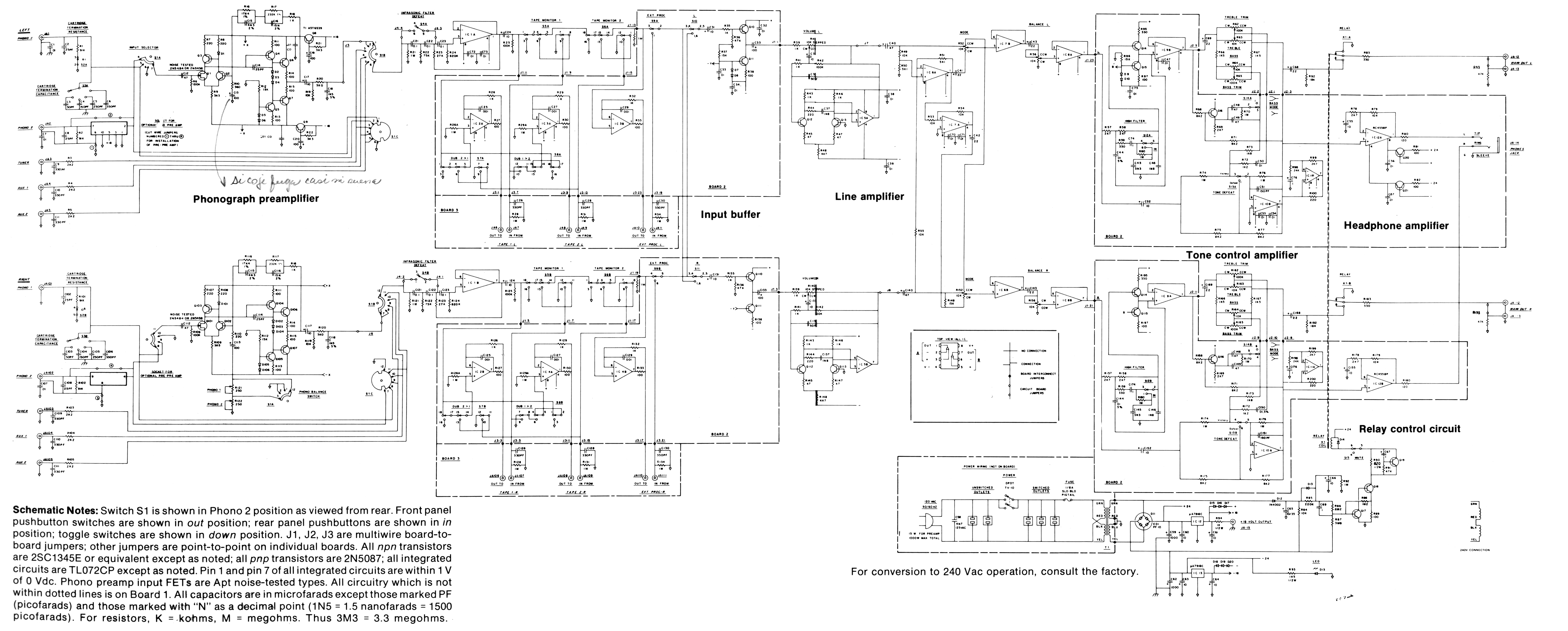

another thought that i am starting to evaluate is borrowing a circuit chapter from apt holman preamp (relay control circuit).
the full high resolution schematic was chopped down to the relevant portion. one nice thing about this circuit is that the after-latch throttle down of holding voltage (less coil heating effect).
season-1 had a brief throw down with the preamp's not-so-great/weak rectifier design. also another site has indicated undersized mains txf.
some informative links about the preamp. if i am going to hijack my own thread may as well go all the way...
the preamp circuit chunk could possibly replace the 555 timer headache to help simplify the overall design.
