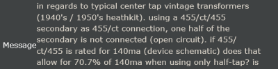

a casual thought, it would be interesting to find out what the actual mains txf rating is suppose to be (va or watts, i'm not picky). as well as what the core saturation limit is for each half of the ht secondary (ampacity, how much load should it handle).

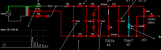

after adjusting the full-tap mod, there might be some build potential and simplicity (no timer circuit).
currently showing inrush with the first 55ms although this is not cold start accurate. toggle the b+ output resistor switch to see overload/surge approximation and circuit stress.

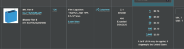

in term of parts:
20uf 1kv film x2 for the front end (fresh parts order needed)
30uf 600v film x2 for b+ and b1 nodes (already have those near the bench)
z-shunt = 200/160/200 5w each to protect 600v caps and all glassware
the 100/50/100 resistors off of the ht tap should help buffer some of the inrush+daily stress/abuse not to mention pad the first rc filter rung/node/whatever. either 5w or 7w for the 100r and then x2 in parallel for the 50r. the first 100r connected to 20uf idles around 3.2w while the 300r after it settles at 3w so resistor wattage value for the 100r should be high, possibly chassis mount like the 300's will be. the b- 100r could be 10w non-chassis mount or low as 5w maybe.

Screenshot 2026-07-22 at 07-18-32 7027a - main circuit 001 full tap.txt - Circuit Simulator.png
clearer view of the circuit, previously posted snapshots look blurry and terrible.
the tapped txf in the sim is programmed with 150mh primary and 0.1237 sim ratio which equals [ratio 1 : 8.084] and produces 650v dc nominal when rectified. the pair of rectifier diodes are silicon and should be rated for 3a 1200-1500v. another reason i am not focusing too much on using a flavorful tube rectifier is reducing 10-15w of stress on the mains txf core. just like with using 0.9a heater rated outputs vs 1.3a kt66 norm, every little bit extends txf life unless there is another major flaw getting exploited.
Looks to me like (15*3 = 15W) + (6.3*4 = 25.2W) + (455*0.140 =63.7W) = 103.9W
So, why did I only use half the high voltage winding, and not the full winding, in the above calculation? Because each half only has a 50% duty cycle, they're used alternately, but never loaded at the same time, due to the rectifier's switching action.
If we were to use only half the high voltage winding with a bridge, although the overall load on the core and primary would remain the same, the (i^2)* R losses in the used half of the winding increase due to the doubling of RMS current through that winding, which would increase the temperature of the winding, possibly (likely) beyond the insulation temperature limit.
