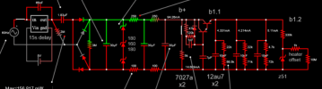

sim for the final mile design, also added v1/v2 sub-circuit loads for tuning the numbers after output bias is finalized (b+ will be lower soon).
65nf across the front relay is/was 68nf advertised, it will be reduced to 33nf to improve soft-start protection when the relay clicks.
resistance for the heater offset load is approximated, need to do a baseline measurement across the 1k for accuracy.
the 120k npn base resistor could be bumped up to 150k or maybe 180k to reduce supply ripple to 50uv Rms or less (sim numbers). have to be careful how much the voltage drop across the darlington, too high will heat it up more than a little.
sim data attached, [edit] corrected wrong cap location on v1/v2 rc nodes (oops), caps after v-drop resistors.
shown above as 10nf each, didnt delete from sim.

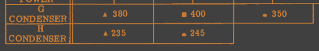

Screenshot 2026-08-04 at 20-40-44 Assembling and Using Your Heathkit High Fidelity Amplifier M...png
closer look at the factory rc filter nodes
Screenshot 2026-08-04 at 20-42-39 Assembling and Using Your Heathkit High Fidelity Amplifier M...png
and the expected voltages, when the preamp is connected. no idea how much the preamp connection might skew things vs solo amp(s).
since the soon-to-be calibrated b1 voltage is looking like 366v so far, i wonder if installing a 400v z-shunt after the npn filter and then feed each node with a 1k resistor to maintain some sort of isolation between each v1/v2 section (instead of 15k/22k/6.8k). adjusting the 2.2k lower for v2 cathode so closer to 6ma can be achieved, seems like dcg-designs went down to 1.5k if i remember correctly.
