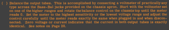

in regards to bass-balance setting, has anyone noticed that the pot adjust affects Rg2 voltage drop? can adjust the balance pot to balance out the bass as described in the build manual or balance out each Vg1 voltage or balance out Vg2 on each bulb.
currently seeing 0.860v vs 1.03v at idle for Vg2 when control grids are balanced around 6.55v each.

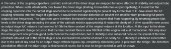

so v1/v2 are getting stressed with the factory design surge, probably a good idea to revisit a b+/b1 z-shunt even though the timed relay circuit has reduced the potential for damage.
i am noticing a variation in power-off output thump when adjusting v1/v2 current draw and the initial npn filter tests (when feeding b+ and b1, thump was zero). after removing the output bypass caps there was still a significant thump.
www.audiokarma.org/forums/threads/untapped-potential-heaths-w-5m.1042474/post-16697490
*16309 design limitations

thats your tubes being unmatched. You want to adjust that for equal current through the tube. The grid voltage doesn't matter, but the better the tube match, the closer those will be.

i might go with 470nf up front instead of 100nf and 220nf for the output stage vs 1000nf stock. to evaluate power-off thump reaction. v2 cathode resistor is at 2k (5.35ma) right now but it will be revised down to 1.8k even though 1.7k might be ideal.
the dcg mod obviously removed the bypass cap so it will be interesting to hear how the normal cathode bias with cap reacts.

The intention of the bass-bal control, is to make a fine adjustment to the Vg1 voltage, so that the DC current through each half of output transformer balances, to avoid core saturation. The only way to set it is as per the manual.
The V shaped graph in the manual shows how core saturation causes distortion at low frequencies. I think the W5M had to include this control, because the Peerless output transformer has a fairly small core, and is sensitive to saturation.
With my amplifiers, one set of KT66s is slightly better matched than the other, so changing tubes needs a tweak of the control.
The only way to have all voltages equal is perfectly matched tubes, but if they aren't, equal current through the tx is by far the most important thing to achieve by use of this control.

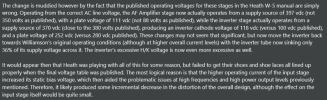

interesting to note the importance of the 6L6 class of tubes. with this boondoggle project and targeting around 15w output that would make 5881/7581a and other glassware a possibility for rolling options. a pair of full metal jacket 6L6's would be interesting.
is it a bad thing to have more tube rolling options with an amp circuit, that doesnt stress/bork the bottles with every on/off cycle?

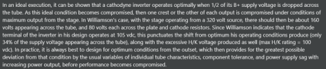

looks like dave's design has the following numbers (anode/cathode):
v1.1 : 75v/1.62v = 3.44ma
v1.2 : 240v/80v = 3.63ma
v2 : 245v/10v = 6.67ma = 3.33ma each triode
although the different output circuit bias/loading might benefit the most from the calculated currents above.
If its running under 6L6 sort of operating conditions, any of the higher-rated variants will work fine and not be stressed at all. Its all within the same family so its not really anything odd. The amps that allow use of extremely different tubes has always made me wonder what its really tuned for.
Swapping tubes doesn't really stress them physically so long as its done carefully. Don't pull them out by the bottle, don't pull them when hot enough to remove fingerprints so you end up flinging them across the room, etc. The more you use the sockets the more it wears those out of course.

front end z-shunt lowered from 500v to 480v (160v x3) also 200+200 added to b+ for excessive over-voltage safety.
v1--v2 coupling caps changed to 470nf and v2--outputs changed to 220nf.
bias core reduced from 330r//3k to 250r solo.
v1/v2 b1 feed resistors changed from previous 5.6k/5.6k/1.5k to 22k/22k/1.5k (factory 15k/22k/6.8k plus caps).

when reducing the v1.1 and v1.2 triode current settings (via b1 feeder resistors) the pulse became more pronounced/worse even though swapping the 100nf and 1000nf factory positions (now 470nf and 220nf) helped change the pop frequency (more midrange less bass, woofer pull-in excursion amplitude & decay).
no idea if running 1.1 or 1.2 or both around 5ma is normal for 12au7. especially since the factory design (even though dave debunked schematic numbers) is 4.68/4.54ma which isnt too far from 5.0ma idle. perhaps the mixture of one triode pulling the circuit down during power-off and finding a suitable b1 rc node capacitance might balance things out, or make it worse...
the general idea being, using a front end triode to drain/sink/slurp the stored energy in the area (at power-off) to reduce electron belch/burp potential... especially out the outputs (lower electron tract) and into the speakers which would inconvenience the entire room (silent butt deadly meets sonic no medley). chassis might need a change of paint afterward.
