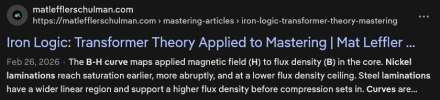

I counted 6 layers of the nickle lams. Are these laminations nickle-iron alloys and if so what? I assume they are not pure nickle.
I also wondered why they are arranged in a single group/stripe in the middle of the laminations rather than dispersed. The purpose of the nickle-iron lams I think is to enhance low-level performance, due to the higher (than iron laminates) permeability at low magnetization levels.
thats a detail thats fully outside of my realm of knowledge but I would also like to know that answer. I'm sure there is a reason for it though.
*basic sales info
*older company
*some basic info about different core metallurgy
*high nickel content datasheet
Screenshot 2026-08-19 at 13-07-56 transformer nickel lamination b h curve at DuckDuckGo.png
dave mentioned the 16309 got into trouble quickly below 30hz at slightly above 20w. nickel construction seems to saturate quickly near its breaking point, over-saturation of flux density.
