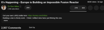

for those who want to venture down a somewhat more advanced power magnetics rabbit hole:
Screenshot 2026-08-19 at 14-32-59 It's Happening - Europe is Building an Impossible Fusion Rea...png
www.youtube.com/watch?v=bPUAKW1Dyek

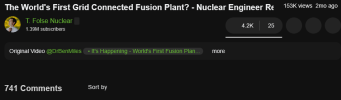

Screenshot 2026-08-19 at 14-35-58 The World's First Grid Connected Fusion Plant - Nuclear Engi...png
www.youtube.com/watch?v=nt4rZgndOoE
**it does help to hear from someone who actually works in the industry vs going solely off of what an informative ph.d venture capitalist says.**
