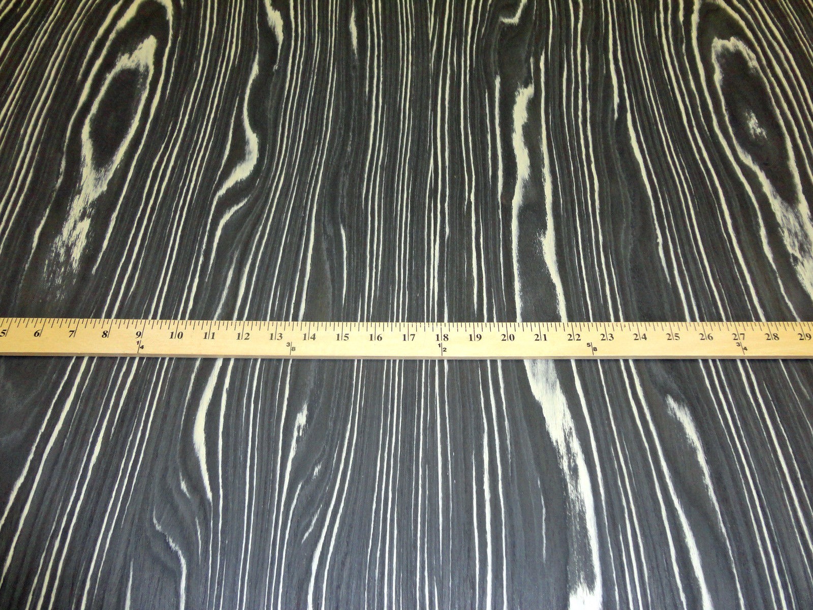

Am somewhat considering doing a real wood veneer on it - but it might be a shame to detract from its originality, it's really not that bad and can't even see the corners issue from 1m away.
Found this video of a very nicely done QL5
Looks pretty good!
I was thinking of staying within a black scheme though - real wood veneer, but perhaps something like a black ash.
Or maybe something wild like this would be pretty interesting :D

Might take a leaf out of your book there, @BillWojo - an aluminium board would look really nice in the QL50, especially in contrasting more natural finish (although probably anodized) matching the platen, against the darker plinth
