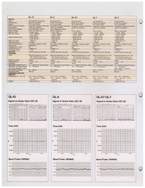

I don’t know if I have the original USA brochures anymore but will look for them. I will post up the English version of those A X integrated models if I can find them.
The stereo shop was reluctant to give me them even though I purchased the A X2, the matching tuner (TX-1 I think) , and the L- F 41. Still have the L F41 and original AT cart it came with. Working wonderfully after bypassing a micro switch for power. Actually well built for the mass produced era of tables.
I have a JVC A X500 also superA but it is the chip design from the 90s era and I just don’t appreciate it as much as those old A X models from 1980. Very clean sounding but has issues with the board and needs work.
Still have the JVC QL A7 six years now and and I still enjoy it. I posted up its brochure earlier in this thread.

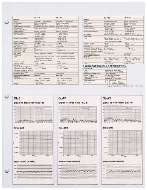

some Jvc / Victor brochures not in Japanese language
Thank you both Snuck and best-groove for posting those brochures. Love the cut away view of the tonearm, it shows just how much engineering went into it. To build that tonearm today would cost thousands, it's very complex and precise, yet to operate and adjust it, very easy! A simple calibrated knurled ring allows VTA to be adjusted on the fly and the top knurled ring can be adjusted on the fly for anti-skating. The adjusting mechanisms "feel" like turning the focus ring on a fine camera lens. Just very well done.

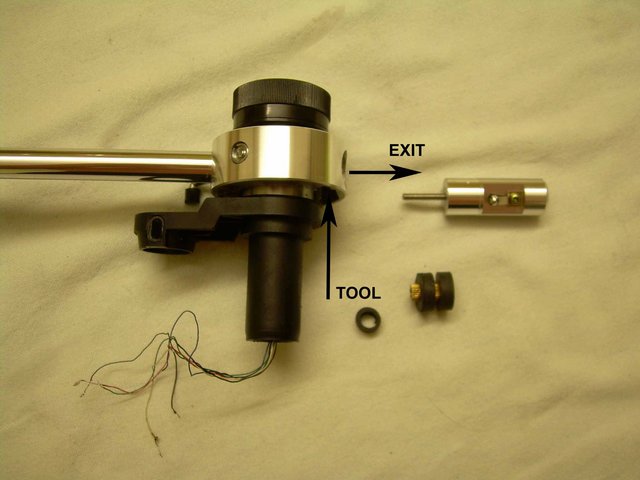

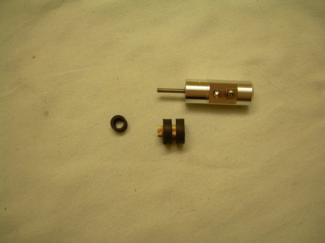

Finally just bit the bullet and decided to fix the droopy rubber damping bushing.
on the JVC QL A7. In my brochure it says that it has the same new gimbal tonearm setup as the 8 and 10 for the pivot and damping, it definitely has a different rest but the counterweight shaft is still the same design. I was unable to loosen the set screw underneath the counterweight shaft.
Tried several times but it seems to be tightened down more than I am willing to torque on it. One slip is all that it would take to damage it so I just removed the counterweight by unscrewing it until it backed off all the way.
Before all of this I removed dust lid, removed platter and the cartridge. Also removed the motor cover as it has a poor solder joint on a capacitor and I think I will try to tackle that problem after this one.
Table has nice flat sides and balanced up nicely on the work bench. The old rubber was so deteriorated that I didn’t have to do much to remove it. It was strangely soft on the outside but brittle and dry underneath. Used some need nosed pliers to get a hold of the rubber (hemostats were my second choice) and it was easy to pull out as it split. Gently pulling so I didn’t hit anything and I only moved it up off the shaft about 5 mm then let go with the pliers. (They are very small hobby type and not your average sized ones for normal electrical work).
Used small dental tools for the rest of the removal. The rubber sets inside the pivot housing and around the brass shaft. The brass is gear cut to hold the rubber in place to prevent rotation. It’s really in there tight and the brass rod is free floating on a pivot point inside the arm pivot housing. Hence, the entire tailpiece with counterweight can act as a harmonic damping unit.
Now I have to find a suitable replacement rubber o ring to use as a replacement. I am contemplating either using several rubber o rings that can stretch over the stainless tailpiece but snap back around the thinner diameter cut brass floating rod. Or I could find something that I could cut a parallel slice and wrap around the small brass rod, super glue to hold it in place and maybe some silicone to make a stronger bond.
What are your thoughts? What has anyone tried? I don’t think there’s a replacement rubber gasket available. Also I left the rubber that is still inside the pivot housing as it separates the brass rod from the housing.
I almost think it will be easier now w/o removal of the counterweight shaft. The cut will have to be aligned on the top side facing upwards as the constant weight pushed the old rubber out of the bottom. Picture the rod horizontal and the pinched rubber squeezing out from the bottom. A few pics for others in case they need. D79A3893-518C-4EAC-815D-7853AE2EDA0E.jpegCCCC6C86-1C70-4AAA-B0CF-998A899630C5.jpeg 1CDCB67C-0B02-4B43-A317-A4056FCF10F9.jpeg C4C0A227-D481-440C-BE27-9B07D142EA1D.jpeg 6CD23730-09B1-4E76-B333-37E4894A6332.jpeg

Congratulations for the repair of the tonearm!! Ans thanks for the tutorial about it. For replacement, some people used wood, some rubbers from hardware stores, I think it's best to keep it with rubber.
Here is a tutorial too :
https://www.audiovintage.fr/leforum/viewtopic.php?t=55306
I used the gasket of the taps, it was necessary to remove some material on the outside of the gasket as it is slightly wider
Question. Is that set screw underneath a Phillips head screw or is it a 1.5 mm Allen key?
Also, how did you get it apart to the point in your photo? Does it simply unscrew out? Does that set screw underneath have to be loosened first?
It is a cross Philips head screw
I didn't want to disassemble all the articulation so I entered from inside the castle with a small and very thin open-end wrench but it was very difficult because the room for maneuver is small.
Later I thought that a complete overhaul of the arm and a rewiring was the best thing to do and I entrusted it to a repair lab.
This told me that it uses softer rubber than rubber tap seals more similar to the original but I kept the one I had used myself.
Best-Groove you are my hero! I am so happy as I now understand! Absolutely helped me with my understanding and methods to attack this problem.
I have a temporary repair job on it using some compressed “impact” foam rubber material used to protect objects from hard sudden impact. I used it as a testing material since it is easy to shape and I wanted to see how hard it would be to fit it in a tight area. I used dental tools for fitting.
But, the results were spectacular and now I don’t want to undo my “temporary” repair. (Edit: the results from my temporary repair material and actually playing a few records. Sound is truly improved with the removal of the old drooping material and the new temporary material) I can’t believe how much it impacted the overall sound and eliminating background noise.
I’m going to see how long it will last. Thinking about using sorbane material for a permanent solution. It’s used in recoil pads for trap shooting and I think it has a similar hardness to the original damping rubber. I really don’t want to remove it all the way though to repair it as it is a lot of work and the wires are old and delicate.
Thank you again! Made my day.

Unfortunately I didn’t think I would be using it as a permanent solution and didn’t take any pictures as I repaired. I took several pics of the last state of repair where the old rubber was removed. They are posted above.
After the old was removed, i cut a square of the very dense/stiff foam rubber used in packaging to protect expensive products. I think it was from some speakers or headphones I had purchased. Cut it into a round shape. about 1 inch long and 1 inch diameter. All by hand with a sharp knife.
Drilled a 1/4 “ hole through the center, cut a slit on the top to slip it over the 6mm brass splined shaft.
It was trimmed down and cut a little longer than the removed rubber. 1-2 mm or so and larger in diameter of the12 mm stainless tailpipe in order to have some compression and hold up the counterweight once installed. The foam rubber would compress more than a solid piece of rubber.
Since it was cut with a slit to slide over the brass shaft, I turned it so the cut was facing up on the top and the solid bottom would see the compression due to gravity and the counterweight.
Then wrapped around with very fine black polyester thread much like tying a fly for fly fishing multiple times to secure it and keep it from losing the position and add to the firmness.
Finally decided to cut a piece of electrical tape about as wide as the new rubber and wrap it as a top layer over the thread. Maybe I should have just left it with the thread?
It was just a test run to see how large of a piece to make and how that foam rubber performed. I just happened to run across it as I was looking for a suitable replacement.
Thought I would purchase some actual rubber after I figured out how to repair it without removing the whole tonearm from the plinth and having to un-solder the wires.
Luckily for me it looked so good I decided to try it out. Results were unbelievably positive and now I don’t want to mess with it. Definitely a huge improvement over the old worn droopy counterweight. Separation and detail is now outstanding. Never knew what I was missing when I had it shimmed.
If I decide to redo it with some solid rubber, I will take some step by step pics. Posted up a pic of the temporary test repair. Definitely need to trim the electrical tape back or just redo it. Again, I didn’t think it would be so functional nor used for more than a few minutes. Now that it sounds so good, I don’t want to touch it! OCD about the look of it though. I’m going to wait until I obtain some sorbothane (sp?). Used for recoil pads and absorbing shock is what it was designed for.

I don’t like to tackle such delicate repairs with something that would be hard to get replacement parts but I hated the final droopy state it was in more.
It wasn’t a pretty repair but it is a great functional repair. My ocd will have to live with it until I obtain some suitable replacement material (I want sorbothane with a 6mm hole or 1/4 in center hole and not the 1/2” I commonly find.
