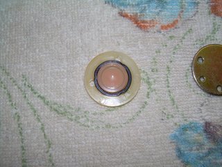

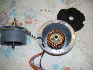

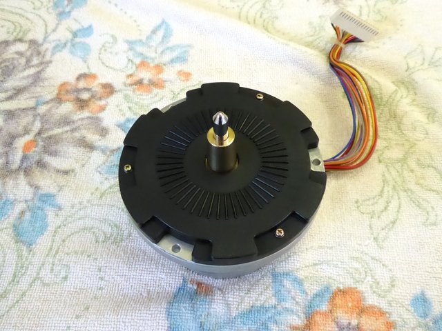

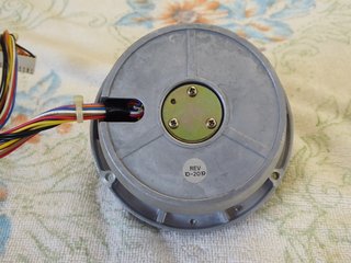

I think you need to take the engine (it's not complicated) apart and check the pivot and oil if there is still any.
For some reason I cannot get the motor to come out of the housing. I can pull it out a bit, but it has a lot of resistance when trying to completely remove…like something is holding it back. Any suggestions?
