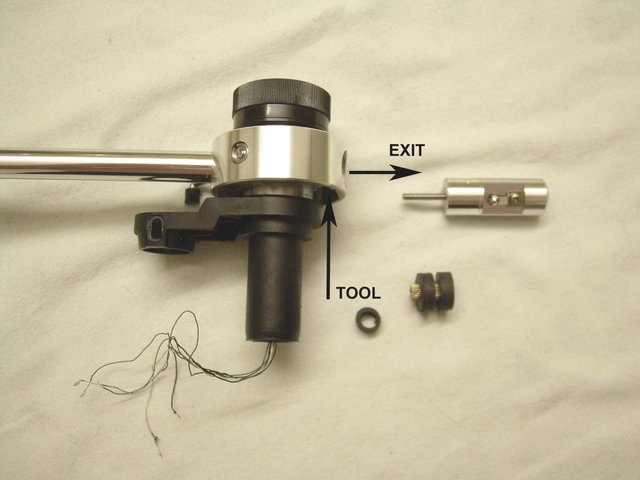

How did you get underneath that bearing housing to unthread the tailpiece? I couldn’t see clearly underneath mine but it looked like a C clip or something similar was holding it together underneath the bearing housing.
It didn’t look like there was anything like a nut/washer for the shaft to screw into.

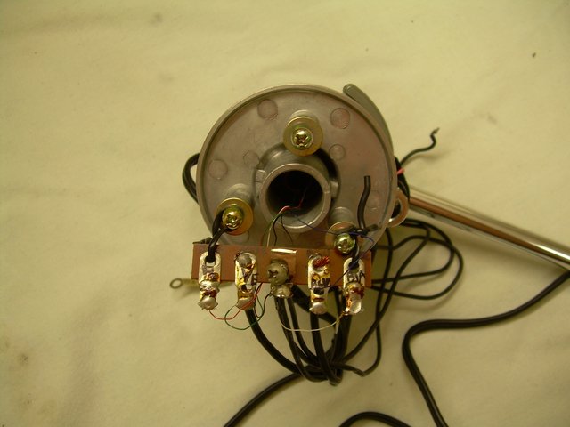

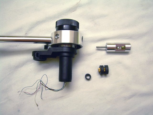

disassembly is much easier in the 7045 arm, in this 5045 it is unfortunately very complicated to unscrew the pin as the nut is located inside the cover that covers the joint.
I had to use a very small hex key of minimum thickness to go inside and unscrew the nut.
Was that with the arm removed from the table? Because I couldn’t see how it was attached underneath the pivot/bearing housing. I could barely see what looked like a free floating C clip or ring. Can you show us the part that you removed from the end? The size of the Allen wrench? Something small like 1.5 mm?
I think you have posted before but I was unclear about the method you used. I don’t think it would be possible with the arm attached. Well for me, I could see the “nut” underneath the housing rotate around but not a hex key opening anywhere on it.

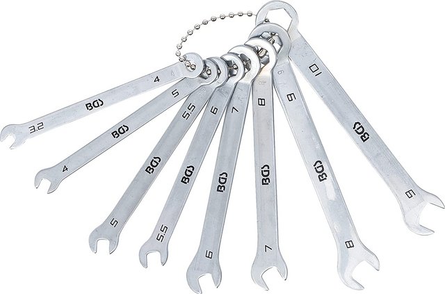

Obviously I had to remove the arm from the plinth, completely disassembled otherwise it would have been impossible to operate.
The mini key "C" if I remember correctly is 4 or 4.5 mm.
It is part of a set of very small and slim mini C-wrenches in different sizes similar to those in the photo.
Thanks @best-groove! I have had some replying that the arm didn’t have to be removed to unscrew the floating tailpiece. It’s difficult to tell since it’s buried under the bearing housing.
Hence why I chose the way I did it now. The rubber bushing has 28.5 mm ends connected by ~ 14mm shaft. Cutting off one end leaves the other end to support the counter weight with a large bearing surface. After a few years of use, I can easily replace it in 5 minutes without any dissembling of the arm from table. The hardest part for me in the future will be removing the dust cover and the counter weight.
