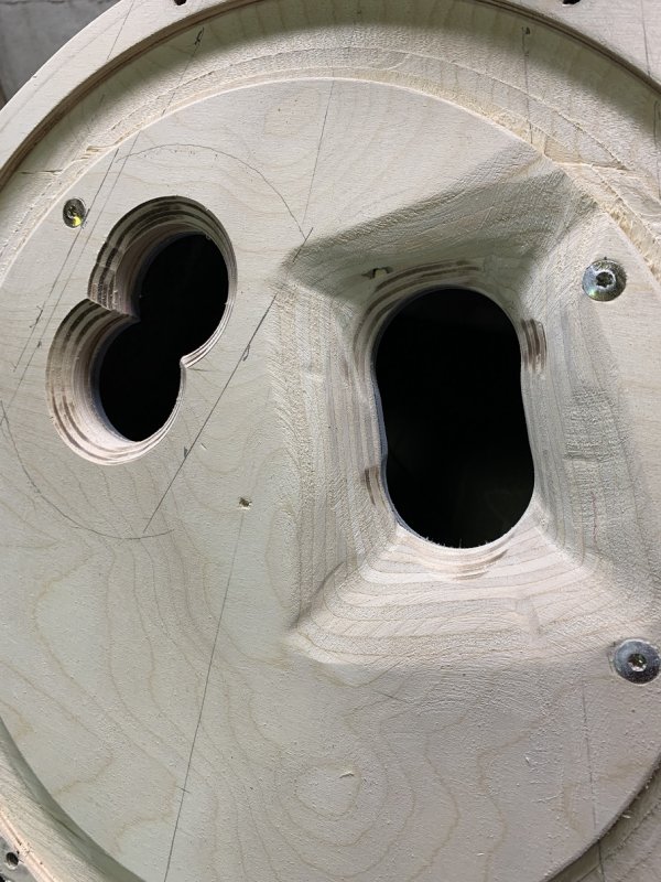

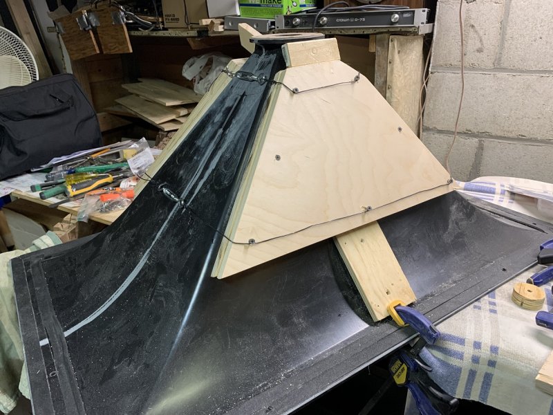

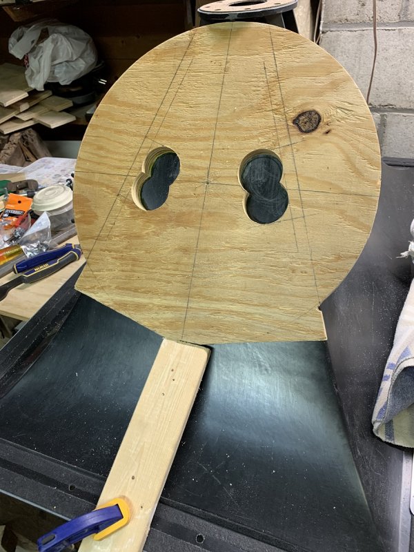

That's right Claude, very much following ChrisA and with a lot of generous advice from him. For example, on his advice those holes are 2" rather than the 2.25" he used and therefore spaced a bit further apart to achieve the 10 to1 compression ratio with my chosen Eminence Delta 15 8ohm woofers. So far, changes from Chris' design have been minimal but perhaps significant in the end.
The double layer of BB stiffening the wider adjacent sides of the horn provide a solid mounting point for the woofer pads. I'm using BB rather than the mdf he used for the woofer mounting pads which while probably not stiffer, take the screws more solidly and I hope allow me to take apart and reassemble solidly and repeatedly.
Also, I'm hoping cutting out a "moat" in the woofer pad for cone travel will eliminate the contact I heard in my testing even at low power 20-40hz. I could install a ring to space the woofer a bit away from the pad I guess but not sure what the sonic consequences would be for the cone/port interface

I find running the 45 degree chamfer router bit deeper on several passes helps me stay on track when free-handing this contouring/"frustumizing" of the ports with a sanding disk on my drill and a detail sander.

Detail of my stiffening double layer of plywood K402 MEH Deliberate Gap.jpg epoxied to the adjacent horn sides is that I deliberately left a gap between them and the woofer mounting plates. The 6 large screws that hold each mounting plate in place then really pull the plate tight against the side of the horn/entry ports. This had the unintended consequence of slightly warping the mounting plates but not so much that the woofer couldn't be sealed against it.
