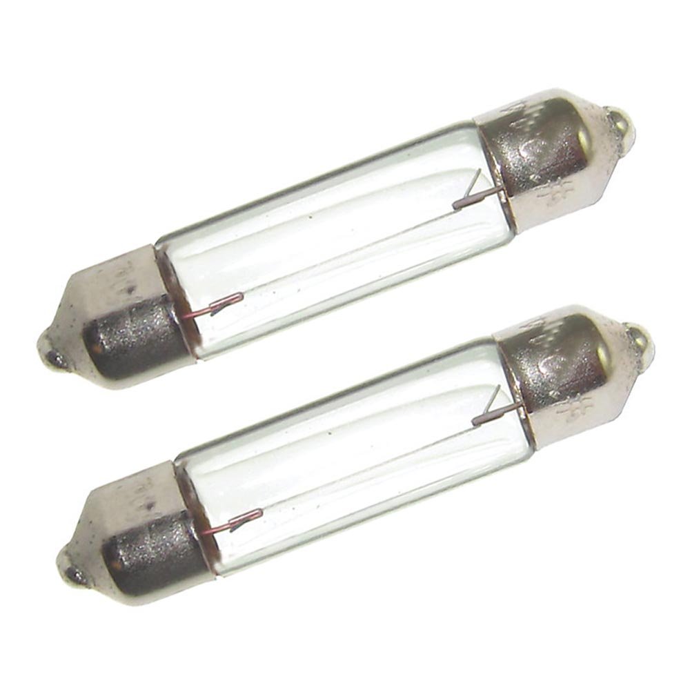

Thanks guys, I did find two fuse type bulbs both ends of the dial. Not sure where a guy can find them, they are pointed on the end rather than flat. Not sure how to get to the lamp for the meter. Do some investigating.

(based on your description) Those are called "festoon" lamps and shouldn't be too hard to find (depending upon the voltage & current draw of the specific lamps required).
(borrowed, generic image from the internet)

If they are 12V, the just go to the auto parts store and buy some LED equivalents.

The lamp for the Dial pointer is still working, I was able to pull one of the lamps at the end of the dial, and it was pretty much black and the place on the other end of the dial, there was no bulb in the holder. I cannot find schematic online, if you were to guess, what is the standard for these bulbs? I'll post a pic of the one I pulled.

The voltage and wattage may be stamped into the end part of the fuse lamp. The ones out of my Pioneer were at least. Those look like the 8v lamps that Pioneer stuff in the 70s used.

Got the multimeter out and tested the receptacles, stayed just under 6 so anything above that should be good.
If you have 6V at the holder, then a 6V lamp is what you want.
I look for warm white festoon LEDs at the dial and be done with it.

Just picked up one of these, and all the lights are dead. Took some readings and there are two of the long bulbs on either side of the front panel, one inside the tuning meter. These measured out at 8.3v of AC. They would be the ones you see coming off the transformer in power circuit. The tuning indicator bar has a small, miniature bulb with attached leads as does the stereo indicator light. Dial lamp is same as the others, 8.3V AC. Having issues with the stereo indicator function, not sure if its working. Found 8.5V led replacement bulbs online, still working on the small bulbs. Hope this helps.
