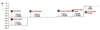

Part 2: Constant Background Hiss & Hum (Conclusion)
Recalling that the background hum and hiss noise was essentially absent with activation of the -20dB muting switch, it was postulated that a reduction in the preamplifier stage gain might resolve the the noise issue. However, according to the Level Diagram in the 771 Service Manual, the preamplifer stage is essential a unity gain circuit as it only provides 2dB of signal gain. And hence, unfortunately, the 771 preamp stage does not offer any opportunity to address the noise issue.
However, the Level Diagram also shows that the power amplifier stage was designed to provide unusually high gain, approximately 43dB. On the F-1499 Driver Board, the resistors, R21/R22 (100kohm) and R25/R26 (470ohm) form the feedback loop voltage divider; with these values the calculated gain is 46.6dB (a bit higher than is listed in the Level Diagram). And, although not shown in the 771 Schematic, the F-1499 board has additional feedback components at R23/R24 (10kohm) and C07/C08 (10pF) for very high frequencies (e.g., >1.6MHz). This extra feedback arm lowers the gain to 26.2dB for MHz frequencies; the corrected schematic is shown below (the additional feedback components are circled).
The high gain in the power amplifier stage does afford an opportunity to possibly address the 771 noise issues. By installing 47kohm resistors and 1.2kohm resistors at R21/R22 and R25/R26, respectively, the power amplifier gain is lowered to a more typical 32.1dB. For comparison, the power amplifier stage in the AU-7500 integrated amplifier, has a gain of 28.7dB. And, now (drum roll, please), with this modification to the feedback loop, the excessive background hum noise and the hiss noise have been eradicated!
Also, note that extra feedback components at R23/R24 and C07/C08 have been removed. Failure to remove these components when R25/R26 is increased to 1.2kohm will cause the amplifier stage to become unstable and oscillate. Interestingly, Sansui discontinued the use of these additional feedback components in the subsequent generations of receivers and amplifiers.

Out of curiosity, what effect did that have on actual measured output power?
The lowering of the power amp stage gain via the feedback loop modification does not affect the maximum power output; this is dependent on the power supply B+ and B- voltages (which are unaffected by the feedback modification). However, the lower gain does impact the power amplifier input sensitivity, i.e., the signal voltage required to drive the power amplifier to full output is now higher following the feedback modification. In use, it means that the volume knob has to rotated a bit more clockwise than before for the same sound loudness. This is actually beneficial since it means that the practical working range of the volume control is now in the rotation range with better inter-channel matching.
