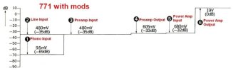

The lowering of the power amp stage gain via the feedback loop modification does not affect the maximum power output; this is dependent on the power supply B+ and B- voltages (which are unaffected by the feedback modification). However, the lower gain does impact the power amplifier input sensitivity, i.e., the signal voltage required to drive the power amplifier to full output is now higher following the feedback modification. In use, it means that the volume knob has to rotated a bit more clockwise than before for the same sound loudness. This is actually beneficial since it means that the practical working range of the volume control is now in the rotation range with better inter-channel matching.

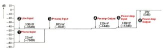

Some inquiring minds asked me what was the change in the input sensitivity with the power amplifier feedback modification. From the Sansui Gain Level diagram in the service manual, we see that a 100mV line level signal is sufficient to drive the 771 to full power output, i.e., 19V (with the volume control at maximum).
With the power amplifier feedback modification, the gain is lowered to 32dB and since the full power output is the same, the input voltage can be calculated with this formula: dB=20log10(V2/V1). Solving for V1, the new input sensitivity is 480mV. And although this value is ~5x higher than the stock value, it is easily exceeded since the vast majority, if not all, of line level input sources can produce outputs in volts.
