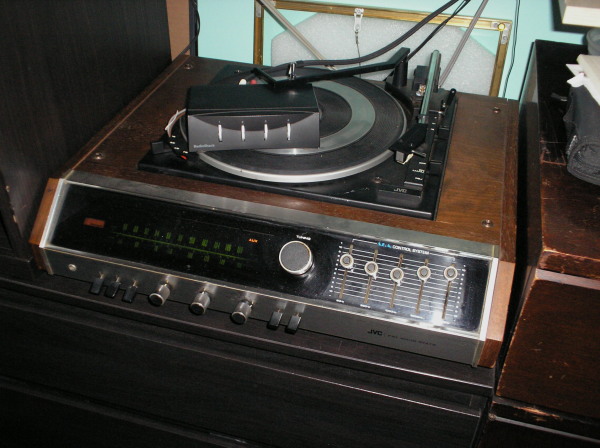

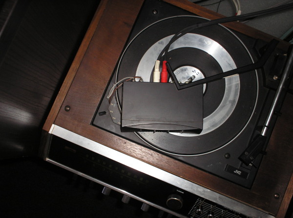

I am thoroughly enjoying this new-to-me JVC Model 4450 I recently found. Screw the BSR, I have my modded SL1200MKII for that. Wharfedale Denton 80th's sound nice here.
Those were probably one of the better all in one units from the 70s. Even has the SEA feature! Nice!
Geh, that's a fun machine! I was marveled as well by how they stuffed in their trademark eq. I must say the record player doesn't look great to me, but is that a Philips 400 element in there? I do like the tuner scale. It just kind of lacks a tape machine? If it's early 70's and for the US market, an 8-track would have really completed it. Maybe it was optional? And maybe so was the record player? Great fun anyhow!
JVC MD 1014 / DT-31 stylus. Some sort of rebranded Audio-Technica. I found a NOS replacement stylus and checked it out on my SL1200MKII. Sounds like my AT70 so I put the cart/stylus/headshell combo on the auction site.
