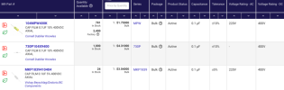

Sounds like replacing the output stage coupling caps is a bare minimum to start. Like I said I'm a novice, so I'm honestly not sure which ones are the coupling caps. Are we talking about the four 0.1uf/400WVDC in the image below? Are there more coupling caps? Any recommendations on good replacements that are reasonably priced?

Are you saying it's better to get 630VDC instead of the original 400? I was thinking of going with the Vishay Sprague for the small electrolytics and Vishay Roederstein 5% 400VDC for the coupling caps as seen in Digikey cart below. Not sure how important it is to do the two smaller .047uF caps, but I added them to the cart. It's about $70CAD now including tax and shipping, which is pretty reasonable.

There's no reason to uprate the voltage. I believe the screen shot I posted shows all the axial polypropylene caps in the original value that Digikey has in stock right now.
