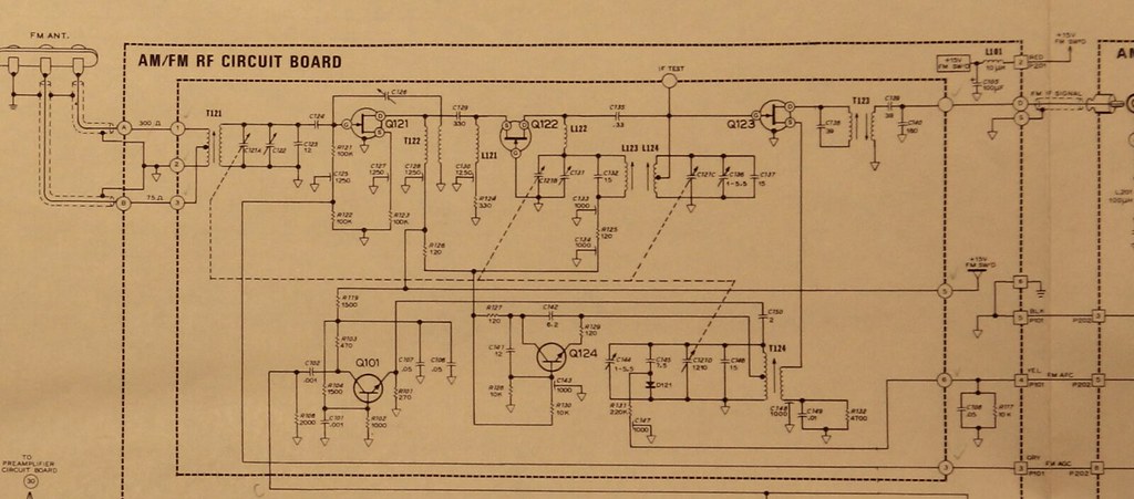

I am at the point where I am aligning the tuner. Could you possibly post a picture of the manual showing the adjustment points as referenced by the alignment procedure, I think it's on Page 31? For example the board silkscreen does not indicate the the caps or coils in the section with the tuning capacitor. T121,L104,T105,C122,C131 and C136. Also the step for the Mixer Transformer calls for T123 to be adjusted. I can't find this.
I can, but not until after the pandemic isolation stuff ends. :(
I have a copy, but I can't get back to it until after the pandemic isolation stuff ends.

I have got the AR-1515 working, after cleaning, recapping and aligning the tuner. I am having one problem still with the tuner, the center tuning is drifting.
I have tried to replace components and check the circuit but I still get the same result.
If I turn the receiver on it needs to warm up for about 10 min until the center tuning becomes stable.
For example.. If I turn it on and let it warm up then make the center tuning perfect and shut it down and let it cool it's quite a ways off when I restart again.
When it's cold and I start the tuning is not right as stations do not have symmetry from left to right on the meter.
I removed the wire for the AFC circuit that comes from the IF board and goes to the RF board. On the IF board side I should see voltage that represents an error that get's sent to the varactor diode in the front end to correct the drift.
If I use a DC power supply connected to the AFC input on the front end and swing the power supply about a volt and a half I get a response that is shown on the center tuning meter. Seems correct.
When I measure the signal that drives the AFC circuit on the front end from the IF board I get hardly any change. The weird part is that the same signal that drives the center tune meter is the same signal that drives the AFC.
I wonder if this is just a problem with all AR-1515's?
Larry has sent me a scan of the manual that describes some of the FM section however it's silent on the AFC circuit.
Any ideas?
I can not find anything wrong with this circuit other than it drifts.
Using a Sencore SG80 I bypassed the front end and sent a 10.7 IF signal directly to the AM/FM IF board. I turned the generator on and let it warm up.
When I power up the receiver cold with the 10.7 signal into the IF board the center tune meter is off to the left quite a bit. Once I let it warm up for 15 min or so the meter is centered a bit to the right.
I used some freeze spray and found that IC203, IC203 and IC204 have lots of temperature sensitivity. Especially IC203, IC202. In the manual it shows this to be a MC1327P however I have a ULN2111A installed. It appears from looking at data sheets that they are equivalent parts but maybe one is better than the other, not sure. Also I have an MC9601 installed for IC 204, the manual calls out a MC8601.

The front end responds perfectly to a change in AFC voltage being fed to it. The problem is that the circuit that develops the error voltage to correct for drift in the front end is thermally unstable. So the part of the circuit that is designed to correct the problem actually adds to it.
I am not sure if it’s the IF amplification between filters or the detector.
I am going to play around a bit more by injecting signals directly into subsections of the board to see if I can tell where the instability is coming from.
