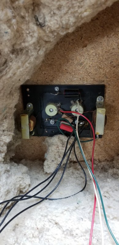

The actual crossover from 1968:

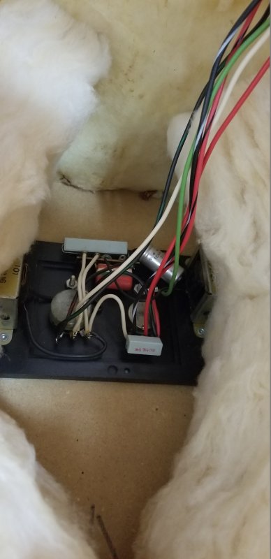

My recapped crossover with (expensive, overkill) Clarity Cap PX caps:

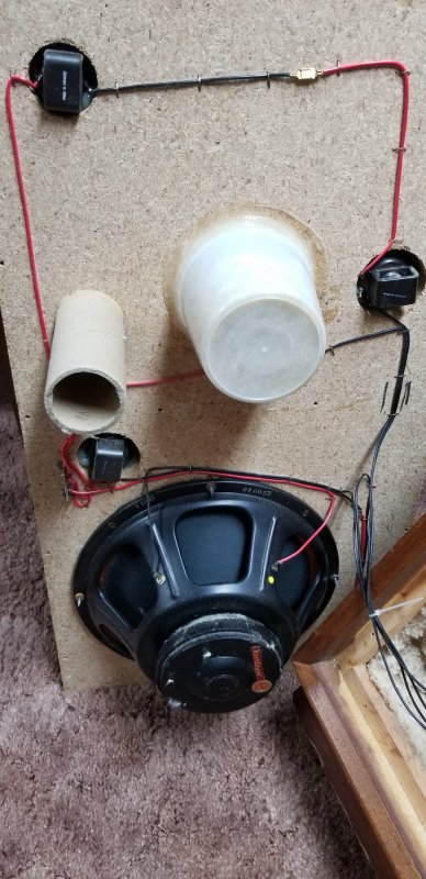

What the back of the driver board looks like when you remove it from the enclosure:

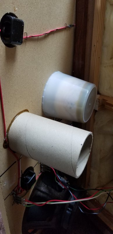

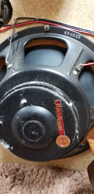

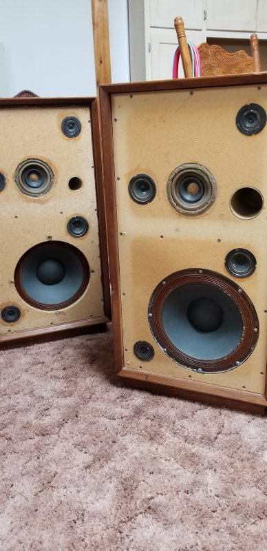

Pardon the pic alignment, I am not very good at this, but anyway, notice the difference in the insulation, the size of the tube and the differences in the control board. Also the woofers, one has the Rectilinear sticker on it, the other does not although both appear to be original in the pic in the previous pic. And honestly, they do sound a bit different. Hard to tell , when hooked up, whether all the tweets are working, but in all both speakers sound pretty good, albeit different from my older Highboys. I'm guessing these new additions are from the mid to later 70's? Now I'm not sure I should mess with them, I honestly thought I'd get inside them and find some obvious need.

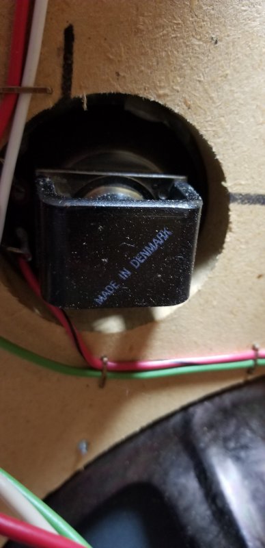

To verify if the tweeters are working, use a paper towel or toilet paper roll. Hold one end to the driver and the other end to your ear. The tube will block most of the sound other than what is coming from the driver.

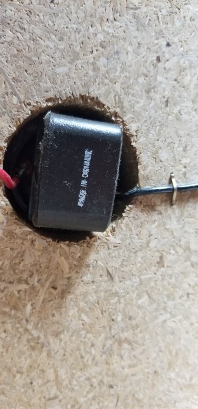

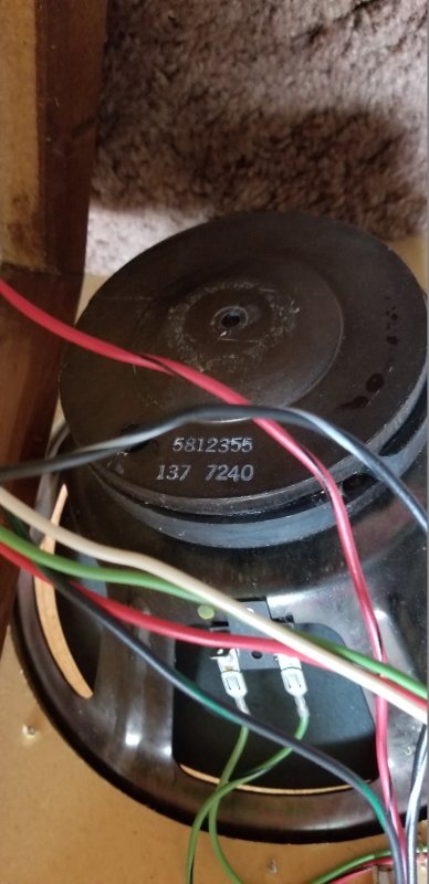

All of that looks totally original - - it's just that your two cabinets display some of the small differences found in the variations (i.e. port tube size). Also it looks like one of your woofers has four screws while the other has eight. The RH woofer has a date code from 1972. LH speaker has cellulose fill, while RH has fiberglass.
I agree with RTally about caps - - you might as well replace them all. The colorful tweeter caps are known as Mullard "tropical fish" caps, and those are most likely 2.2uF values. The mid caps are probably 60uF but could be 90uF - - you'll need to confirm.
Are there studs holding the control boards on? Just remove the nuts on all of them? A couple appear to also be holding parts on the board.....
