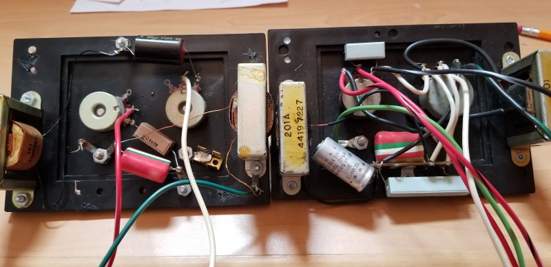

Ok, going on the 'the only stupid question is the one not asked' mantra, can someone please id each part of this board for me?
This speaker with the cellulose insulation is the earlier model. The two round things are the rotary controls for adjustable tweeter and midrange output. The two squarish metal wrapped devices at far left and right are inductor coils - I assume one for the mid and one for the woofer. These should require no further attention - - leave as is. The brown rectangular component in the center is a fixed resistor - - looks like it's connected to tweeter circuit, and again, no reason to touch this unless you see signs of burning.
The black cylinder at the top is the capacitor for the midrange - - this should be removed and replaced with a new cap of similar value, but higher voltage is OK. Same for the red striped component - - this is the 2.2uF tweeter cap - - remove and replace with new.
ra.ra, As I wait for parts to re cap the speaker we talked about, I tore into the other unit and it seems to be wired quite differently using different components. It appears to have been worked on prior because I found bits of old solder and clipped wire ends in the bottom of the cabinet. Therre is that same red/green/white cap as in the other spkr, but the larger cap has different values. Its a Temple 303-60uf 50 vnp. I considered getting two of all the caps so I could do both speakers, but now am glad I did not.
Well now... that is a bit perplexing and clearly your "pair" has one speaker each of two different iterations of the Rect-III. This is just as we suspected, and the possibility of different cap values for the mid driver was mentioned in posts #63, 70, and 79. The smaller cap value (60uF) results in a slightly higher crossover frequency, and I assume this was fully intentional in order for the mid to blend with that particular woofer.
The rotary controls appear to be from different suppliers but this should be of no concern. Also, the RH speaker has an additional resistor - - again, most likely you should leave "as-is". The most curious thing is the significant difference in wiring, and it is difficult to assess this without having schematic circuits drawn up. To put your mind at ease (and simply for additional information), you might spend some time sifting through the many AK threads on the Rect-III to try to confirm similar circuit arrangements.
Good to see that you were able to remove the x-o boards, but I'm surprised you did not confirm the silver cap (60uF) before ordering parts for both cabinets. My suggestion would be: replace both striped caps with new 2.2uF caps; replace the black cap with some parallel combination to make new 90uF; replace the silver cap with parallel combination to make new 60uF; and spray/clean the rotary controls. Re-attach all loose wires, replace internal stuffing, re-assemble baffle boards, then plug-n-play.
More experienced Rect-III owners may have better or more specific advice, but you might drive yourself nuts trying to fully understand the variations in these two specimens. They are slightly different speakers designed to the same standards, so it'd be best to replace any removed components with "like" values.
