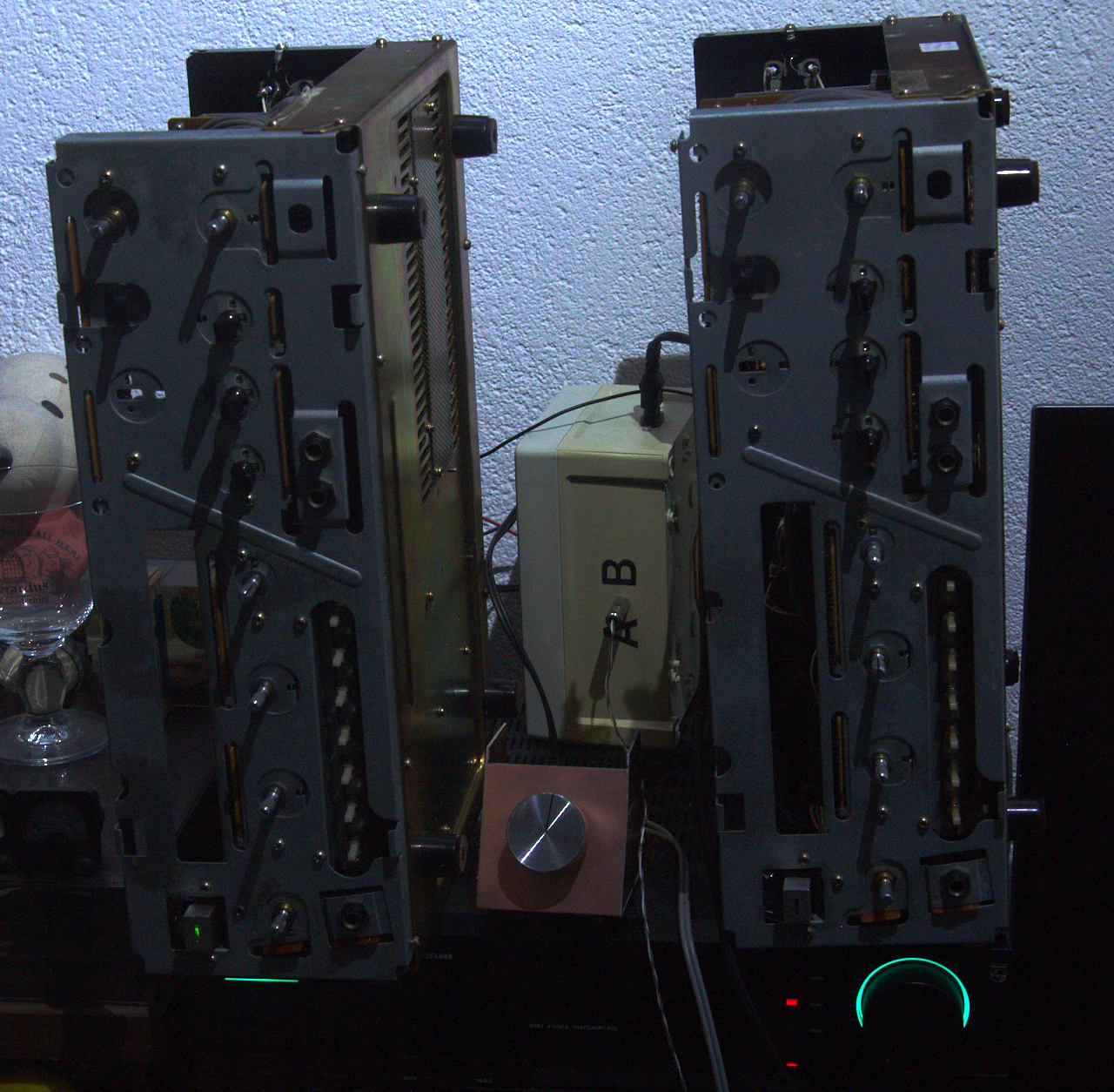

I just did a shootout between the VFETs and laterals:
The big volume control is connected to REC OUT of my trusty DFA888 and splits the signal to the inputs of both power amps. The big A/B box at the rear is my speaker switchbox that I can toggle between the two amps. Do that a few times and I won't know which amp I listen to. Then I tried to hear differences while toggling the amps. I did not hear any difference whatsoever. As was to be expected. Both amps sound equally sweet on my DIY speakers.
Now I only have to do the writeup...
