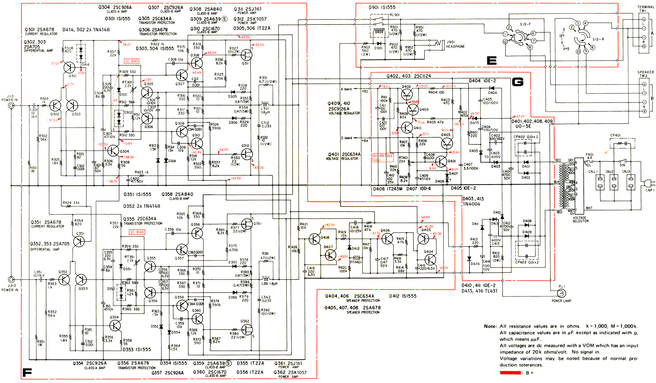

Well, that's the reason I tackled the Sony. A fairly common amp with the compound topology that I'm a fan of. It is not a very complicated circuit and yet gave me quite some headaches... TA-5650 is similar but the TA-8650 is not because it's a source follower. Just replacing the VFETs with laterals will suffice (and adjusting the bias).

Dunno about Yamaha B-2 (too complicated for a quick glance) but the TA-4650's protection is simple and effective. Only if the VD-1221 goes phut it can't cope with this failure because it wasn't designed for that event. Regular overloading is handled just fine.

I need to update my writeup. A 4650 I modded bounced back with catastrophic failure of the laterals due to the Joepiecon 10 µF/400 V caps failing. C403 and C413. Turned out that the reactive current going through them exceeded permissible ripple current and once they failed the negative bias voltage of the laterals disappeared and they went into full conduction. One pair tragically failed but luckily the other survived. With some effort I replaced the electrolytics with 106/100 film caps and that works better. Film capacitors can handle much higher currents than electrolytics but are much bulkier.
