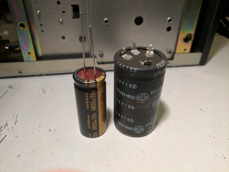

Hello,
I'm starting with the restoration of an Sansui AU-217, as far as I could see, the restorations and recap aren't quite often so I would also like to post how everything goes as well.

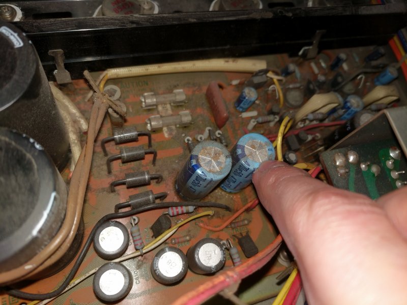

I would like to ask you guys regarding the PSU capacitors (6800uf 50V), the thing is the original ones have 4 connectors and the polarity connections have 20mm of lead space but the new caps (I didn't bought any yet but I would like to replace the originals with Nichicon KG series) have 10mm, so I'm a bit stuck here.
I saw some people from different models modify the board to attach snap-in connections (I don't really like to modify the board) and another guys attach the lug type connections but I'm not sure how they do that, some others replace the original interior with new ones keeping the original external capacitor shape.
Any help here??.
Thanks and cheers,
Bruno.
For the AU-217 and AU-217II - the original 6800uF 50V PSU Electrolytics are 4-pin snap-ins - 35mm diameter - 60mm height - lead spacing of 22.5mm
Current possible replacement's are
NOS Panasonic TH-A 8200uF 80V - drop-in replacements currently in stock at Mouser Electronics
or Nichicon UKW 6800uF 50V also currently in stock at Mouser Electronics - these are leaded which can be bent to the correct required lead spacing

Thanks a lot!, I will go for the Panasonic ones because I really like the drop-in replacements.
I will post further news!

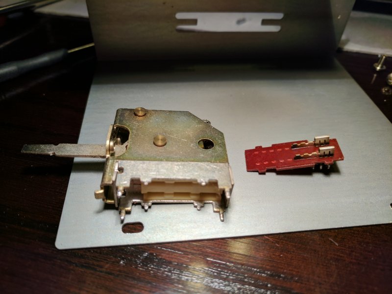

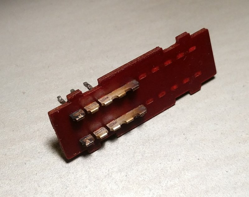

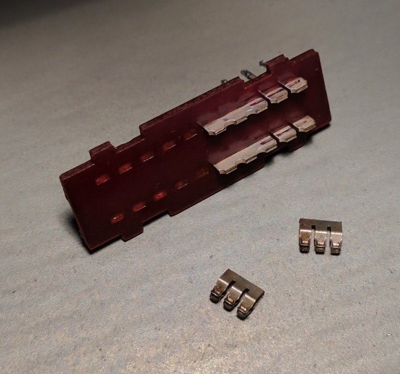

Recently I cleaned some AU-217 toggle switches by using the method described by AK memer Kale (Ithink): Completely reassemble the switch, taking out the small contact parts and cleaning all. Even needed a donor switch as one of the smal contact parts was deformed.
PITA job but great results, superquiet switching for many years to come.

Hi John, thanks for sharing your experience! Can I ask you more information about this method? I was searching in the forum and I could not find anything. Thanks!
Bruno
will
Bruno
Hi Bruno,
Follow this link and you know what I mean.
http://www.audiokarma.org/forums/index.php?threads/another-sansui-au20000.699933/page-3
Be aware that you must have patience, a steady hand, a looking glass and a good eyesight (to look for the parts that fall on the floor and seem te be invisable untill you crush them with your foot) to dis-/re-assemble the switches (did I mention patience?).
Have fun
-John-

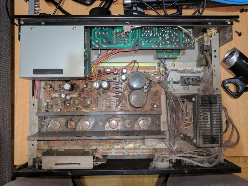

I would like to post some progress about this restoration, this is my first one so probably I won't have as much details as expected!

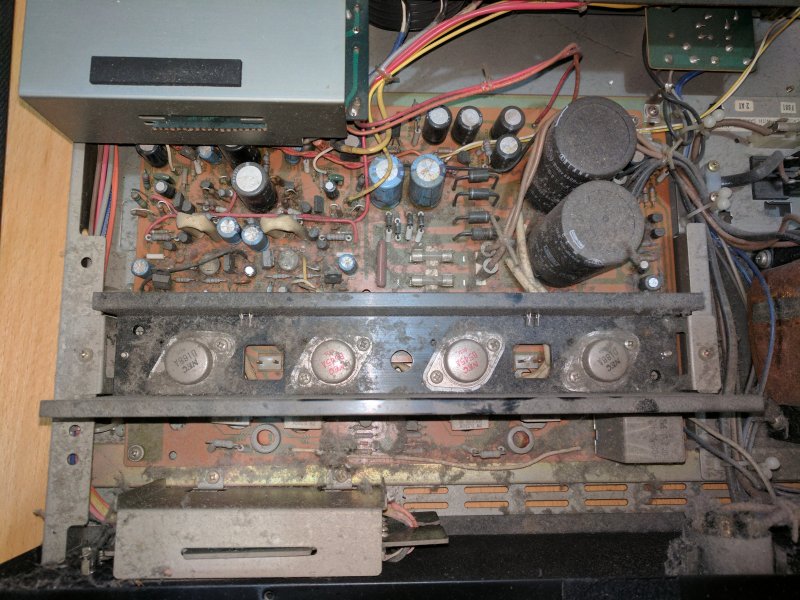

First, some pictures some minutes after I received the amp:
The amp itself:
Some leaking caps, there were several but I took a picture on these only:
After cleaning, it seems the guy was using it as notebook holder or something like that because there were some sticky sweet alike dirty:

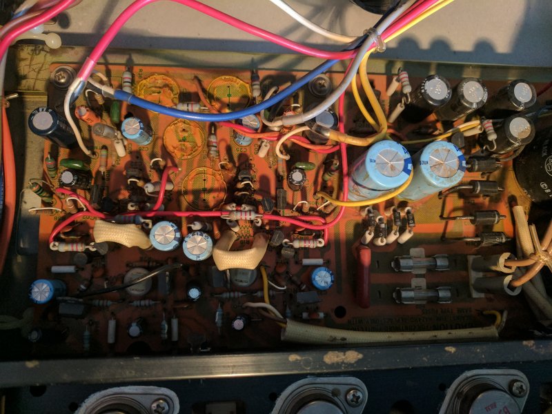

Recap-Restoration starts here:

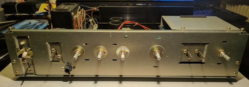

I removed, dissasembled and cleaned every switch (thanks John (jd-audio) for the details!):
Before switch cleaning:
After switch cleaning:
I tried to disassemble all potentiometers but I couldn't make it... the volume and input switch looked a bit complex to be disassembled so I went for cleaning without disassemble (if you have any link regarding how to disassemble them, I will be very thankful!)

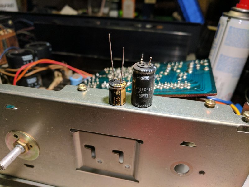

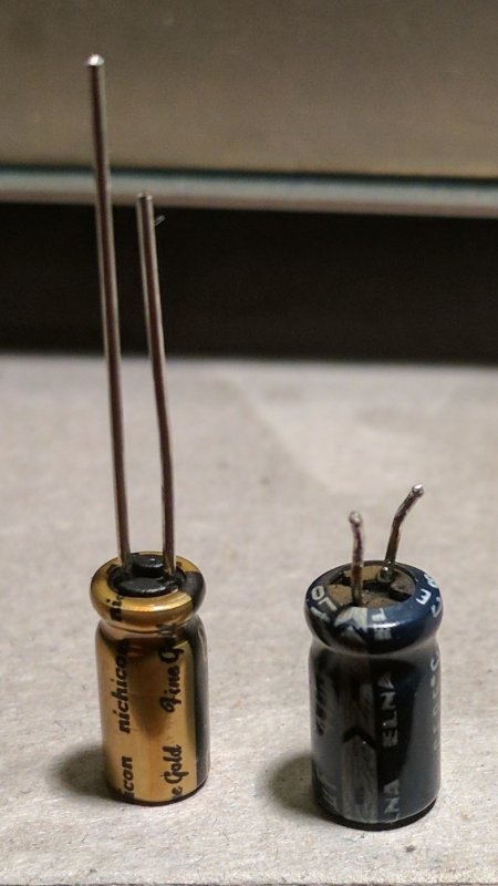

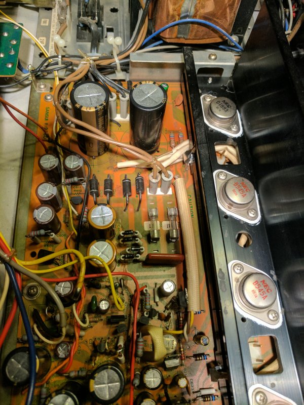

Some old vs new caps, I replaced all of them, I used Nichicon MUSE, KZ and FG series and ELNA Silmic II:
Thanks AUD101 for the details about power supply caps, I decided to go for the Nichicon instead of the drop-in replacement

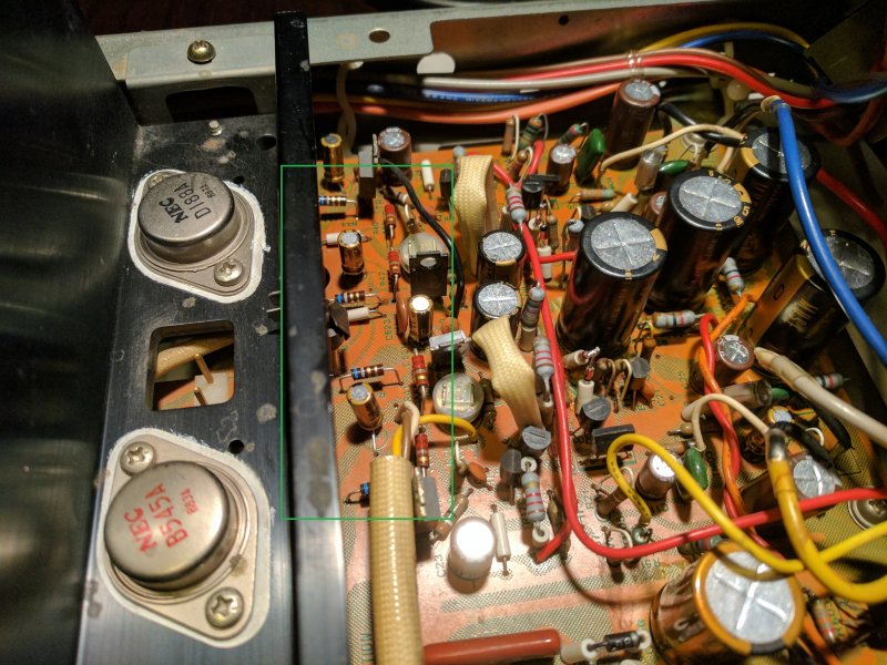

Deadly glue!, I decided to remove it mecanically and after 3hours and some small scratches, most of it was gone. I read to remove it with thinner but I wasn't so safe with it, if somebody has any better way, it will be really appreciated!, I was so frustrated with the glue that I forgot to take any picture afterwards:

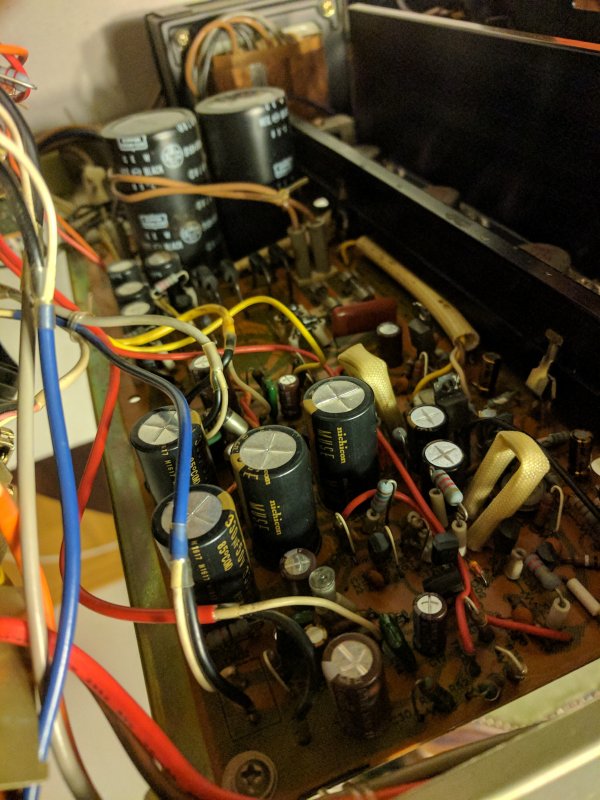

Nichicon MUSE over the cleaned circuit board:

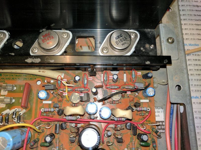

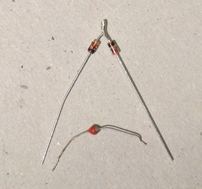

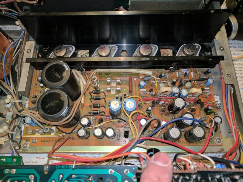

Varistors VD1212 retrofitted with 2 x 1N4148 in series
Power supply caps in their final resting place:
Fuse resistors replaced:
To be done: Replace BIAS timmer pots (I have to pick them up today) and replace old white thermal paste

dedero - looking good! :thumbsup:- Here's a method for glue removal from forum member Kico ---> My solution for easy AU-717 Sansui glue removal

Part list, true, that's something I forgot to post, here we go:
Equalizer Board F-2758
Equalizer Board C01 1 uF 50 V - REPLACED
Equalizer Board C02 1 uF 50 V - REPLACED
Equalizer Board C05 100 uF 6.3 V - REPLACED
Equalizer Board C06 100 uF 6.3 V - REPLACED
Equalizer Board C13 47 uF 10 V - REPLACED
Equalizer Board C14 47 uF 10 V - REPLACED
Equalizer Board C15 3.3 uF 50 V - REPLACED
Equalizer Board C16 3.3 uF 50 V - REPLACED
Equalizer Board C617 220 uF 35 V - REPLACED
Equalizer Board C618 220 uF 35 V - REPLACED
Equalizer Board C619 220 uF 35 V - REPLACED
Power Supply, Protector Circuit y Power Amp Board F-2760
Power Amp Board C01 1 uF 50 V - REPLACED
Power Amp Board C02 1 uF 50 V - REPLACED
Power Amp Board C07 47 uF 50 V - REPLACED
Power Amp Board C08 47 uF 50 V - REPLACED
Power Amp Board C09 330 uF 50 V - REPLACED
Power Amp Board C10 330 uF 50 V - REPLACED
Power Amp Board C11 47 uF 6.3 V - REPLACED
Power Amp Board C12 47 uF 6.3 V - REPLACED
Power Amp Board C15 330 uF 50 V - REPLACED
Power Amp Board C16 330 uF 50 V - REPLACED
Power Amp Board C23 100 uF 6.3 V - REPLACED
Power Amp Board C24 100 uF 6.3 V - REPLACED
Power Amp Board C25 100 uF 6.3 V - REPLACED
Power Amp Board C26 100 uF 6.3 V - REPLACED
Power Amp Board C27 1 uF 50 V - REPLACED
Power Amp Board C28 1 uF 50 V - REPLACED
Power Amp Board C29 470 uF 6.3 V - REPLACED
Power Amp Board C30 470 uF 6.3 V - REPLACED
Power Amp Board C601 47 uF 6.3 V BIPOLAR - REPLACED ***KEEP BIPOLAR IN MIND***
Power Amp Board C602 1 uF 50 V BIPOLAR REPLACED ***KEEP BIPOLAR IN MIND***
Power Amp Board C604 470 uF 6.3 V - REPLACED
Power Amp Board C605 47 uF 50 V - REPLACED
Power Amp Board C606 470 uF 50 V - REPLACED
Power Amp Board C607 470 uF 50 V - REPLACED
Power Amp Board C608 100 uF 50 V - REPLACED
Power Amp Board C609 100 uF 50 V - REPLACED
Power Amp Board C610 100 uF 50 V - REPLACED
Power Amp Board C611 100 uF 50 V - REPLACED
Power Amp Board C612 6800 uF 50 V - REPLACED
Power Amp Board C613 6800 uF 50 V - REPLACED
Power Amp Board C621 3.3 uF 50 V - REPLACED
Power Amp Board C622 3.3 uF 50 V - REPLACED
====FUSE RESISTORS START=====
Power Amp Board R39 220 ohm 1/4 W - REPLACED
Power Amp Board R40 220 ohm 1/4 W - REPLACED
Power Amp Board R41 220 ohm 1/4 W - REPLACED
Power Amp Board R42 220 ohm 1/4 W - REPLACED
Power Amp Board R43 6.8 ohm 1/4 W - REPLACED
Power Amp Board R44 6.8 ohm 1/4 W - REPLACED
Power Amp Board R45 6.8 ohm 1/4 W - REPLACED
Power Amp Board R46 6.8 ohm 1/4 W - REPLACED
====FUSE RESISTORS END=====
Power Amp Board VS01 VD1212 - 2 x 1N4148 in serie - REPLACED
Power Amp Board VS02 VD1212 - 2 x 1N4148 in serie - REPLACED
Tone Control Board F-2759
Balance - Tone Control Board VR01 250 k ohm - CLEANED
Volume - Tone Control Board VR02 250 k ohm - CLEANED
2 x Trimpots 470ohm --> extremely difficult to get... one year later and I cannot get it anywhere... the original trimpots were fine to tune the BIAS current
Speaker relay: Omron MY4-02 DC24 - REPLACED
