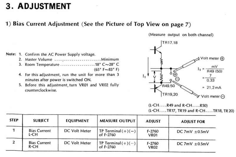

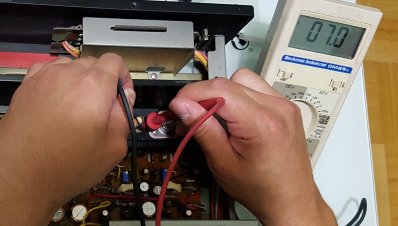

Hi All,
Okey then, after quite a "while" I officially finished this restoration, I received the 500ohm Bourns 3296Y-1-501LF multi turn (specifically this model fits perfect with the pins layout), thank you guys for the confirmation as 500ohm replacement instead of the factory 470ohm one!
DC Bias adjustment manual instructions:
DC Adjustment at 7mv as specified (with the new trimpots in the background):
I'm not really sure whether this trimpot replacement was the solution for the loud pop but I cannot hear it anymore... @Leestereo I was taking a look in google and different forums and I couldn't find the expected values for DC offset at the speaker terminals, in case you have some information, please let me know!
