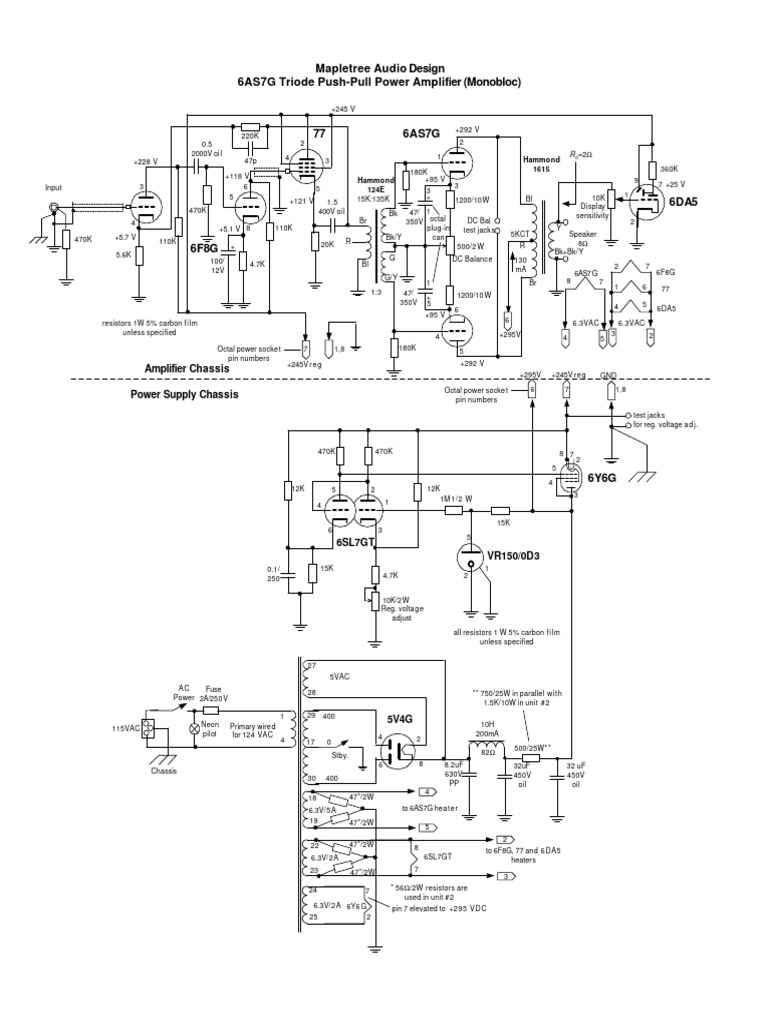

Do you have any drawings of a good amp that uses the 6AS7 tube for outputs.
seems needlessly complex but I've never built anything around that tube. Just seems like something worthy of building around and i have a couple in the "one of these days" pile.
6080 is another option, basically the same as a 6AS7 but in a less-cool looking bottle.

6BX7 - something like this, @gadget73 ?
Yes, I have a bunch of 6080WA tubes, but I use them for my DIY U-OTL :
yeah that would do it. I might go with just a single section triode as a driver, maybe a 6J5. Either way it would be a pretty simple amplifier. Depending on the particulars, maybe tickle in a little feedback, either plate to plate or global as you prefer.
