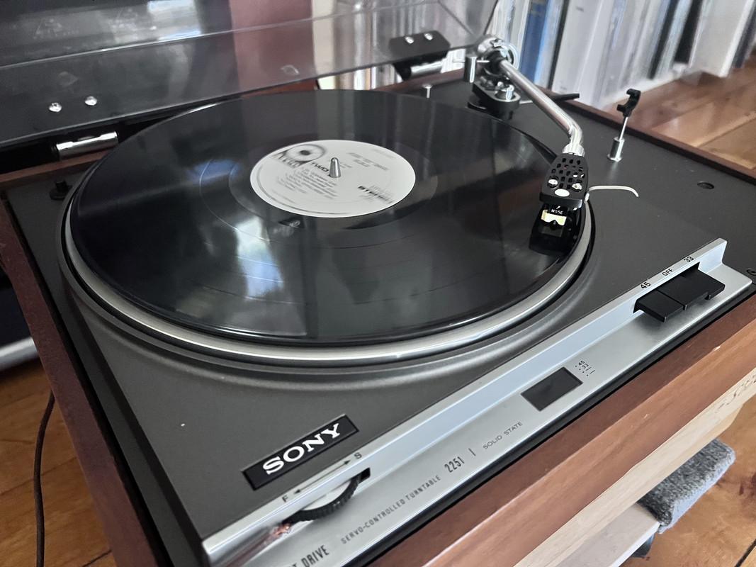

Table showed up in great shape today. Seller did a wonderful job packing it.
Thanks everyone who helped in my addition of this fine table!
Cartridge on the original head shell is a Audio Technica AT11E, but no stylus. For now just using another head shell with a Shure M55. I have a AT13Pro13E that I might use, or I may just get stylus for the 11E.

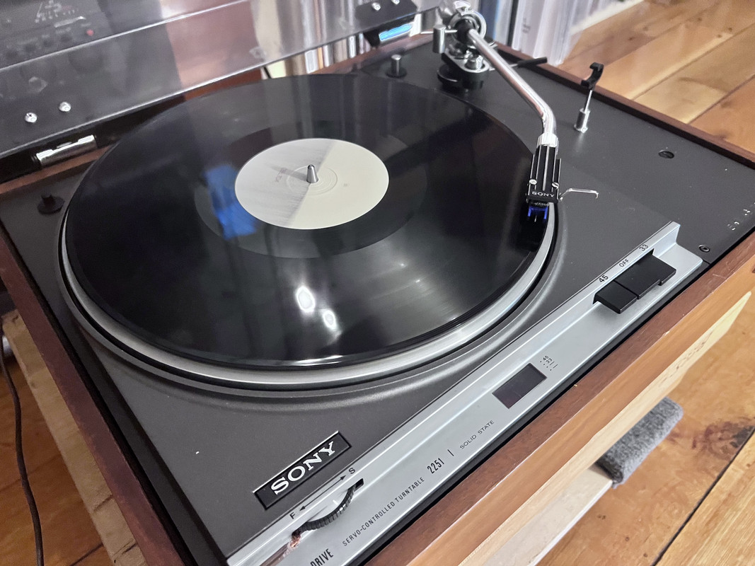

This is the one I picked up Tuesday. Spent a little time cleaning it up..
Speeds easily dial in to “dead nuts”, confirmed by this RPM/WOW phone app. Wow looks pretty decent to me for a 50 year old turntable. This one (and the first one I got) are absolutely silent. Plinth is looking decent but not perfect; it’s got a few dings and scratches but looks nice overall. Dust cover is cleaning up nicely but hand cleaning and polishing is a pain for me.. It’ll get there.. :)
