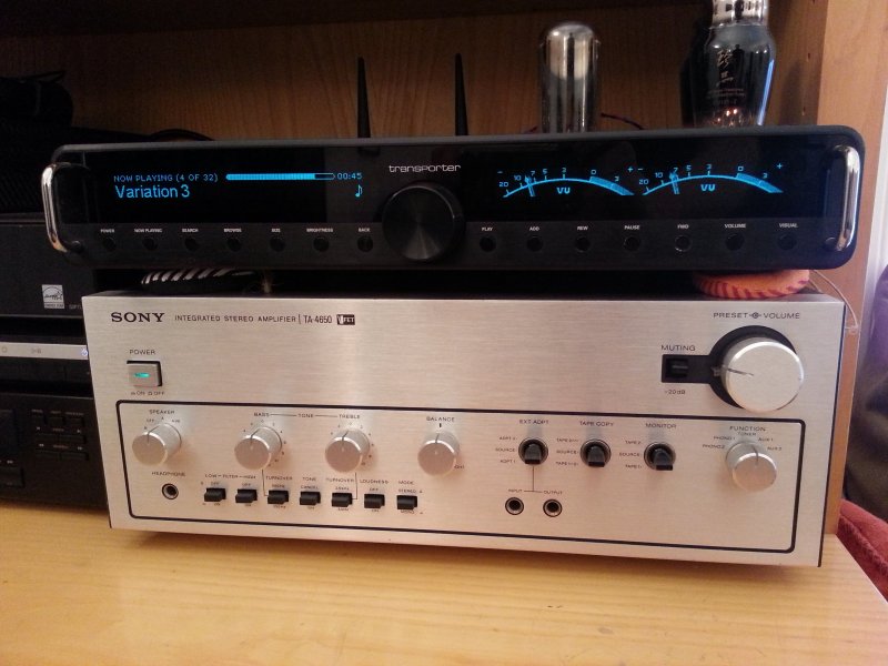

You have to picture the other side of the camera--a tired, happy dude with a beer, trying to decide between Goldberg Variations, Beck, Shaun Colvin, Ella...
Okay, it's been a month and a half since I heard any music from this amp, but I really, really think the sound is much awesomer. I hear more air, more snap, texture...
Thank you ALL so much for your patience and thoughtful comments-especially Echowars, joshvi, DRecovery, Ilimzn - I'm sorry if I've forgotten anyone. I'd be a sad sack without your help.
Now, I think I'll wait a day or so before matching transistors to take care of that DC offset! :)
