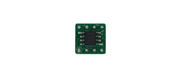

Great news!! Shhhh, don't tell Jim H., but when you are feeling a bit flush, you can also upgrade the other two opamps in your pre with OPA2210s (edit: see post #509) for another boost in performance. Then upgrade the power supply to a linear, regulated supply (see post #1) and without touching a soldering iron you'll improve upon an already wonderful phono pre. Very glad to hear you are enjoying your B3 and thank you for contributing to the thread!
What I really like here is that the use of the opa2210 drops the noise floor by 6dB! I recall seeing a few posts about the use of the opa2210, in simulation, measuring “higher” in noise and something about it not being designed for audio. But neither of these were true and actually the opposite of the truth. I hope Oranda will reply if I am mistaken..
In real life objective measurements, Jim has shown that it is indeed lower when the opa2210 is installed.

Not sure what you might be referring to, but the OPA2210 has great low noise specs. Yes, there is a post on this thread questioning its use for audio, but audio use is not only in the application notes, its also recommended for audio use by johnc124@DIYaudio who is a VP and general manager at TI.
Props to @oranda as his suggestions reached Jim Hagerman and the opa 2210 implemented into the Bugle MC after Jim measured the performance w ~ 6dB lower noise floor. That was with just one 2210 op amp being installed.
Here’s a recent review, https://www.tnt-audio.com/ampli/hagerman_bugle_opa2210_e.html
Great article! Can't thank Jim Hagerman enough for joining the thread, offering his expertise, and not only testing but also incorporating one of the suggested mods into his fantastic Bugle phono preamp. For those with existing Bugle phono preamps, its very exciting to see that Jim now offers plug-in OPA2210 upgrade modules:
I ordered one and popped it into my Bugle and it works perfectly. Hoping to continue to hear positive feedback for either those with new 2210-equipped Bugles or from those who have modded their older phono pres.

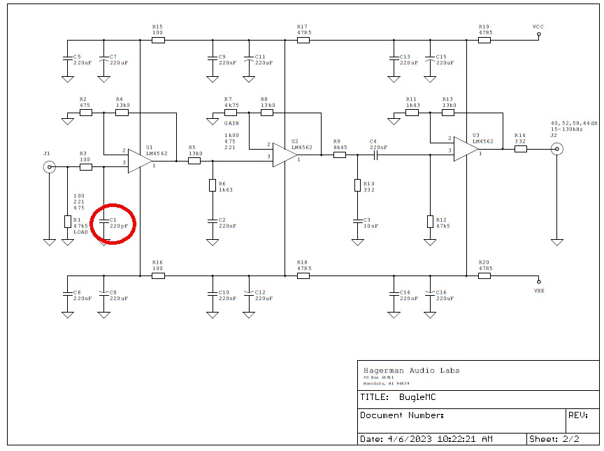

However.....this caught my eye on the newest iteration of the bugle (bugle mc):
V3DZ8cC
A 220pF input cap?
I remember Jim saying a few months ago that on the latest bugle versions he put in a 100pF cap:
For the latest version of BUGLE I've placed a 100pF in parallel with R2. This is good and bad, one of those engineering compromises. Good in that it reduces the possibility of hearing WiFi, bad in that it adds 100pF loading to the MM cartridge! Pick your poison.
And in the shop I read 140pF input capacitance (which is plausible, 100pF for the cap and 40pF for the parasidic capacitance of components)
Why now a 220pF cap?
To me, part of the appeal of the bugle was it's low input capacitance, it used to be 0pf (well, there is of course some parasidic capacitance in connectors, pcb traces etc, about 30pF if I measure my clone).
Very low input capacitance is very beneficial to some mm cartridges with MR stylus, especially if they have laminated cores.
I didn't see a switch for the posibility to bypass this cap
I changed this to a 100pF capacitor. Did not update published schematic. Opamp has also changed. I am constantly trying to wring out the best in each and every one of my products, so they do evolve.
This capacitor is here to reduce the effects of nearby WiFi, cell phone, and radio. If you require super low input capacitance, check out my CORNET MM, as it comes in around 10pF. Tubes tend not to rectify (demodulate) RF interference as much (compared to PN junctions) so I didn't add the RF filter.
