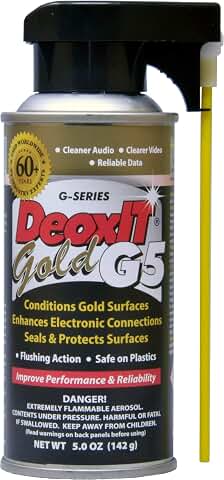

Does it matter which type of “bottle” of D5 and G5?
Is this not the right liquid version of the D5 and G5?
Now I’m thinking D5 and D100 and their “G” counterparts may not be the same at all. :confused:
All of those are the concentrated versions. The small pic with the 3 pack is D5 (regular DeOxit), Fader Lube, and G5 which is the "Gold" mentioned in the original directions. Red - D5 is general cleaning, Yellow - G5 is for maintenance after D5, and the Blue/Green - Fader Lube is specifically for sliding controls. A little dab'll do ya here. These are the concentrated versions.
The sprays are what many of us have used. All the same cleaners and conditioners, just in a milder, more dilute mix. I'm going to transition to the concentrates, myself. They seem to be better suited for precision while the sprays can be messy. The flip up tubes to get in tight places are not great and tend to carpet bomb instead of actually getting into tight places directly. But the above pictures you have provided are the same products as these sprays, just in a more concentrated form.
as someone who will literally be doing this for the first time I’m thinking I better just follow the directions with the exact same specific versions that the OP is referencing.
Which exact ones is the OP talking about when saying the D5 and G5 sprays and ‘liquid versions of the same in bottles?’
That’s what I’m trying to decipher.
So the ones I've used are the ones in the spray cans I pictured above.
There has been some discussion in the thread about what you are asking, but I explained it about as best and concisely as I could. The ones you pictured are the concentrated versions of the sprays and will work fine. A little dab'll do ya. They'll work the same as the sprays.
You can delve into the entire thread if you'd like. I've read it all, but it has been a while. As with most everything, there are differing opinions and questions about changing formulas and other conundrums over the years' lifespan of this thread. I look at this as white noise... The sprays work great and by the vast majority of accounts it's the same magical mix. The first page is a fabulous guide to use as a checklist as you work.
The sprays can be messy and some have lamented over spray and a resulting stickiness on the circuit boards, but I have not found this to be a problem. I have only used the spray, myself, but I'm going to transition to the concentrates the next time I run out of the sprays. The sprays do a great job.
