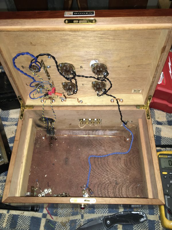

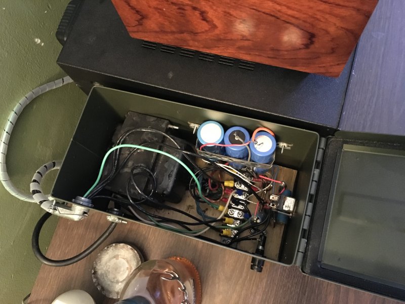

One of my goals was to re-use old stuff (as long as it still measured OK), and whatever I had lying around. It resulted in a project that's pretty messy inside, but didn't cost much, and it still sounds pretty good.
I'd like to eventually fit in the better biasing as Dave Gillespie redesigned it, and so on, but it's time for me to move on to other projects: I need a good preamp to go with this.
When I first posted here I had just started moving it from the original Bogen steel frame into this humidor (never kept my cigars at 70%, may as well use it for something else), thus the delay.
Unbelievable!! I've seen some different approaches over the years, with separating the power supply and audio circuits one of the more popular different approaches to use. But absolutely never have I seen them split up between a humidor and an ammo box. Very well done!! I cannot imagine anything winning out over this entry into the "unique and different" category!
