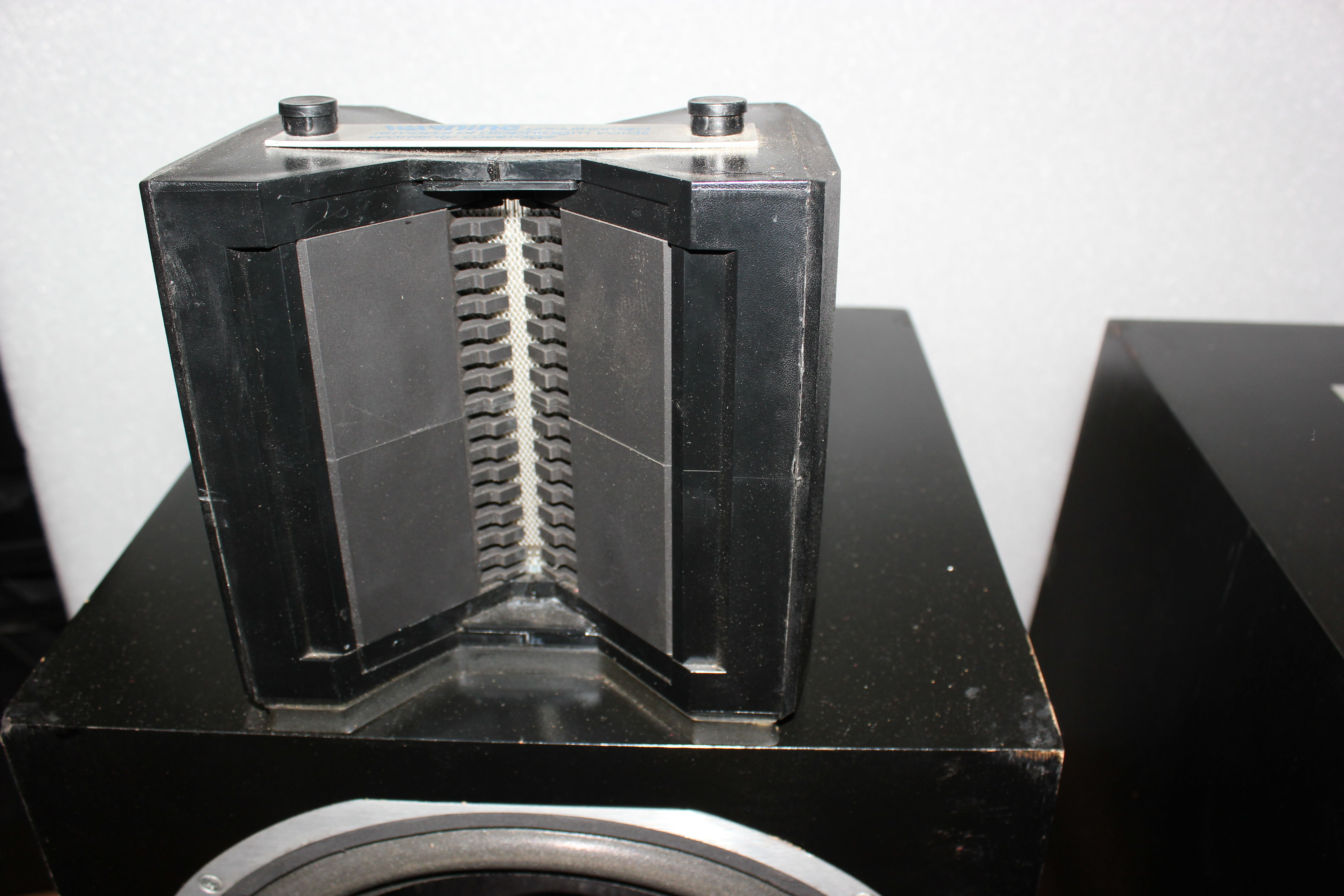

I see you’re running the silver Heils so that seems like it’d be v1 or v2, I think that the only thing that changed is the color of the plates though.
No.
There are "black" Heils, where the metal "fingers" are painted black (current offerings and some past models), then there are "black" Heils where there are what appear to be black rubber "overlays" that lie on the plates and the "fingers" are black plastic (AMT 1D).
Silver Plates (could be painted black):
Later Painted Plates (notice the plate count is way down):
AMT 1D Plates (like on the Ethyl Mermans except with the standard bolt heads on top as on the silver plates):
yes
These are the Heils on my V5/ 1980s AMT Monitors, black with the high plate count of the silver ones pictures above, and note the rubber wedge below it..
Our V3 Heils are black also, look identical. Original woofer partially visible on top:
