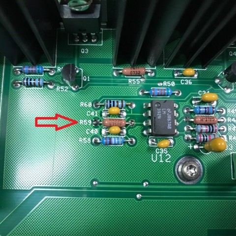

I recently acquired An Aries 1 with SDS. Sometimes the SDS doesn’t settle to 72v and instead stays at 115v. It sometimes flickers back and forth between the two. I’m not hearing a sonic difference. Just doesn’t work as it should. Any advice would be appreciated.
This is a design flaw in the SDS with the threshold detector that determines when the motor is switched on and off; despite VPI's claims that this is a rare occurrence, the potential exists in every unit they ever produced, though it shows up more often on the lower power motors (5.5/7.5W).
It is also easily fixed by paralleling R59 with a 1K Ohm resistor. There is a thread on their forum that covers the problem and the fix:
http://www.vpiforum.com/viewtopic.php?f=12&t=8956#p32148
Do you have images? I'm pretty sure I can figure it out, but nice to have an image pointing out the resistor before I open it up.
Oddly, once I oiled the motor I haven’t had any issues but I’d still like to apply the change since it is a known problem so I’ve ordered the resistor.
