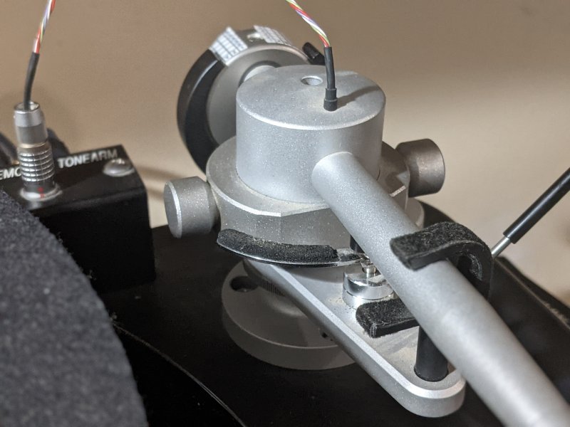

Hi I have a question regards to this arm.The two side knobs for the Azimuth seems to be non adjustable.I tried unscrewing them but it would not budge,.Is there some sort of set screw to unlock it or this model its non adjustable,I know I can do the Azimuth using the counterweight at the back.This is a VPI scout.
Yes, they are fixed on that arm as I mentioned in the other thread. Use the counterweight orientation or the SoundSmith Counter Intuitive you have on there to fine tune adjustments.
https://www.sound-smith.com/accessories/counter-intuitive-vpi-tone-arms

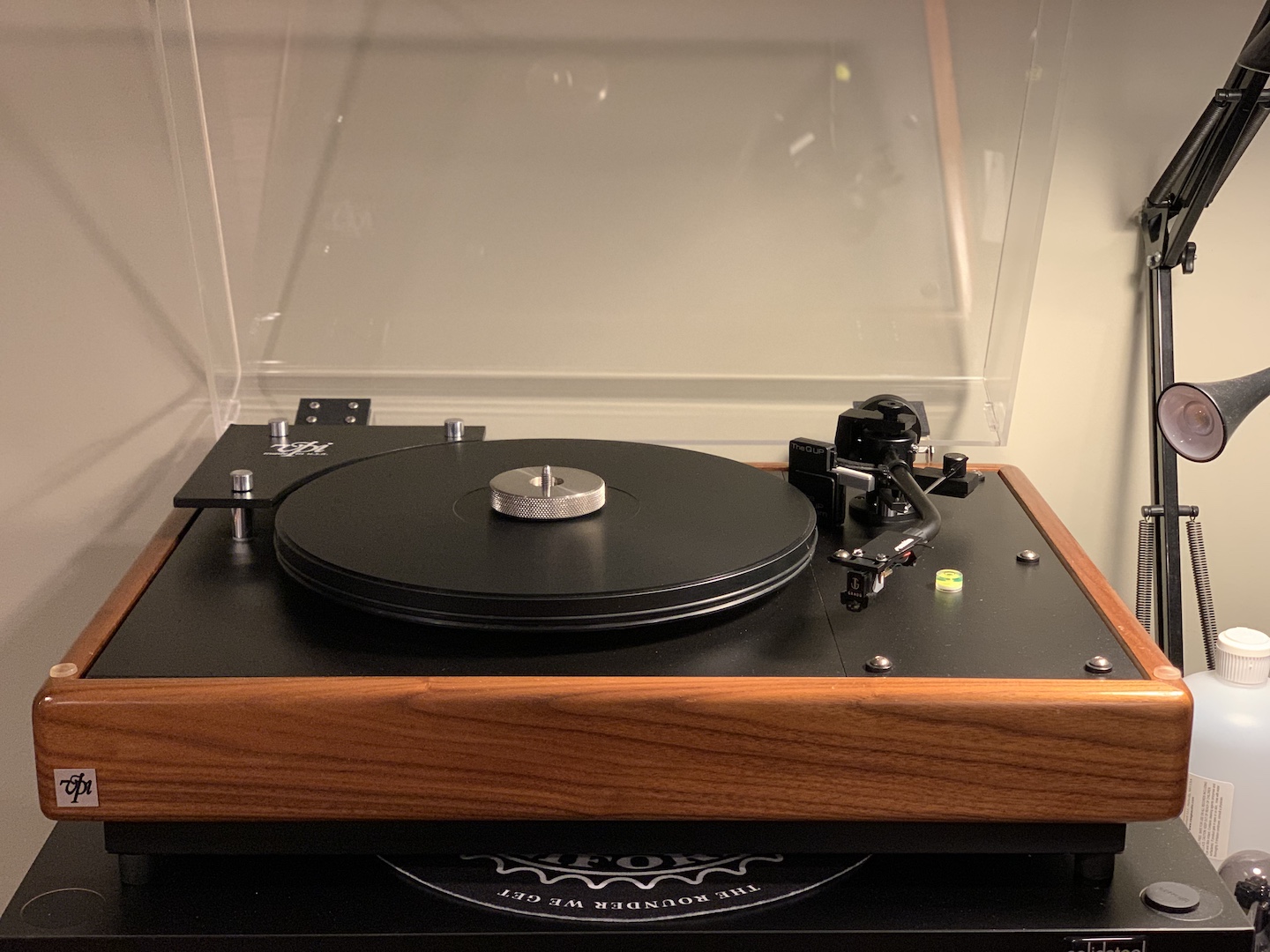

Years ago enjoyed both a VPI Scout, then a Scoutmaster, which I souped up with various platter upgrades, speed control, arms, etc. Then I got a bug for vintage, and moved on. Well, today I made a trade for this HW19II with a Graham 1.5 tonearm, and I'm really enjoying it. While I never owned one of these, I had a couple of friends that did(can't remember which version) and always liked the looks and feel of them. Didn't realize how large, and how heavy they are. But Harry wasn't fooling around when he made these.
Anyway, glad to be back in the family
Very happy with this table, but am curious about performing some basic maintenance. To begin with, how do I remove the platter and spindle to oil the spindle bearing? Can't find any info about that. Is it possible on this table?
And I assume adding a drop or two of oil to the top of the motor is the way to handle that piece?
There's a lot written here about the HW-19. Folks such as Tedrick, and I have written a lot.
The Platter should merely lift off the Bearing. But I'll note that I have seen HW-19's where it appeared the Platter was actually like a press fit onto the Bearing Shaft-Spndle, so, use caution.
It would take me a lengthy response to tell you how to do bearing maintenence and lube, but I'll comment a little. Usually Mobil 1 5-30 will be fine for the bearing, and one drop for the Drive Motor Shaft. 30w or 40w will work for the drive motor. Insure you place that oil where that shaft enters the motor.
There will be a Bearing Ball on the bottom of the Bearing Shaft. Inspect it, and replace if needed. It is .250" in diameter. With a clean bearing well, and a flashlight, one can also inspect the small thrust bearing disc at the bottom of the Well without the need of removing the Bottom Screw Plug.
Long Q-tips on a stick come in handy for wiping out without full disassembly. Insure you leave no cotton behind.
After cleaning, the Bearing only needs about 2 drops placed into the Bearing Well so the Bearing Ball-Thrust Plate stays lubed, and then with a finger, lightly apply an extremely ultra thin coat to the Bearing Shaft, and replace without forcing the Bearing Shaft back down into the Well. You may also very lightly coat the top Bushing within the Bearing Well if you like.
It is very easy to over-lubricate.
Thanks.
I'm familiar with maintenance for turntables, VPI's included. But was wondering how to get at the spindle bearing. I've tried gently to lift the platter off and it's not moving. There doesn't seem to be a need to do anything. Speed is spot on, platter moves freely, so I'm not concerned. But was wondering for the future how to get the platter off.
I went down a similar road, Scout, Classic and Prime. I bought a HW-19 on a whim, and when it was damaged in shipping, decided to rebuild it completely. New or refurbished every last piece. I have almost enough spare parts now to build another.
Thanks.
It lifts straight up. Probably a bit of vacuum created by the oil in the bearing well.
Thanks.
As explained, the platter should be able to be lifted straight up off the Table. And as I mentioned earlier, it can be possible that the Bearing Shaft (which the threaded spindle is part of) may be a press fit into the Platter itself.
If you find it is, I would leave it that way. And to not try separating the two parts. To do so might create excess platter wobble.
Regardless if all seems to work properly, no issues noted, it will be a good idea to inspect the Bearing, do a clean and re-lube, and from there you'll have piece of mind knowing all is in proper shape, and that you have a known starting point as far as bearing lube maintenence goes.
I know over the many years, I have discussed the HW-19 with many other owners about the standard non-inverted Bearing that was commonly used on the HW-19. That some had found damage such as galling, wear, pitting of the small Bearing Ball at the Bottom of the bearing Shaft.
By right, that Bearing Ball should be easily removable, and should move-rotate within the Shaft's machined depression for the Bearing Ball, but I have encountered some who have had a near impossible time to extract that Ball from the Shaft.
If that Bearing Ball has any damage noted, it definitely should be replaced. The standard Ball that VPI provided was nothing special, just a 10 cent chromium steel Ball is all.
I eventually swapped the metal ball for a .250" ceramic ball from Boca Bearing. (was about $5) Much harder, and much more smooth-round than an average metal bearing ball. So hard in fact that the ball can survive the absence of lubricants, and of course would probably last a lifetime provided proper lubrication of the bearing was insured.
Usually, such ceramic bearing balls don't wear like steel. Under extreme pressure, they don't commonly wear or gall, they will shatter. For such to happen with the HW-19, one would probably need a 70lb platter.
I know there's a good deal of technical reasons why certain materials are selected for bearing mating surfaces-materials. The Tungsten Thrust Bearing Pad that resides in the bottom of the bearing well is said to have a rockwell hardness of 92. Still, it can wear over time, a small depression can-will form.
A ceramic ball can possibly accelerate wear of this tungsten thrust bearing, but I think with lubes, this will be a non-issue.
The whole idea of the Bearing Ball, and thrust plate-pad, is to provide the smallest contact patch-point between the two. That the Platter and Bearing are essentially just riding on an extremely small contact surface not much larger than that of a Pin Head.
Here's what I used SI3N4 Ceramic, at the top of this list shown.
https://www.bocabearings.com/products/bearing-and-ball-types/balls?ProductType=0
So the platter/spindle was able to be removed, and I have been using qtips to clean out the well. Added a few drops of Mobil DTE light oil. Thought I had some bearing grease lying around so ordered a tube and will add when I get it. Other then that table running beautifully.
Thanks for the help.
