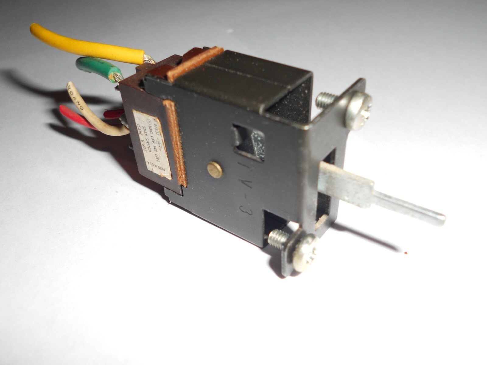

SELECTOR ASSEMBLEY
The selector assembly is a pain-point reported by most Yamaha B-2 owners and for this reason it makes the top of the priority list for improvements.
Unfortunately, simply cleaning the original selector switches does not solve the issues every Yamaha B-2 suffers from. This is because the open air switches that are exposed to undesirable elements, operate signal and VDC within the same switch unit. Even minor smoke and moisture deposits can create grime buildup which in-turn can become conductive and bring DC in the signal path, causing POPs and crackles when operating the switches. Additionally, oxidation of the now 45+ years old contacts provides less than ideal contact, rubbing away some of the B2's magical sound. Unfortunately, when improperly cleaned with abrasive materials by novice technicians or weekend warriors, the silver plating of the original contacts gets permanently damaged and this is actually a very common problem.
In order to permanently correct the selector assembly issues, I have developed a new assembly board with functionality that is transparent to the user but that it is technically much more superior and more reliable than the original design. This is because in the newly redesign selector the mechanical switches do not handle signal switching. The signal switching is handled by state-of-the-art sealed relays that are operating well below their rated specs, hence are expected to easily exceed the reliability of the original design.
Under the new design, the signal integrity is preserved as is the consistency of the functionality of the switching assembly. As a result, the redesigned functional utility is better than when the B-2 was brand new.
There are some operational differences between the original B-2 functions, as follows:
  • The rear input #1 is now a direct path to the driver boards. This is function that most audiophiles prefer, in order to take full advantage of the DC design of the B-2. The downside of this feature is that a DC leaky preamp could destroy the B-2.
  • The rear input #2 preserves all the original functionality, allowing for capacitor coupling and gain control, just as the original design did. However, the coupling capacitors used are good quality polypropylene caps, much better then the original tantalum caps. The pots I use are dual 50Kohm pots mounted in parallel to preserve the original 25Kohm input impedance of the B-2. The reason for the dual-pots is because they are a readily available part and because the two plastic retainers inside the pot are better than one plastic retainer inside the single original pot, which breaks easily and it is an annoyance for many B-2 owners.
The implementation of the new selector requires a qualified technician that understands the B-2 but the entire process is well documented and has a medium level of difficulty.

POWER SWITCH
The B-2 power switch, US and JP version are prone to mechanical failure which ends up in sheered lever arm.
This happens because the internal shaft lubricant dries out or the incorrect lubricant is used (eg WD-40).
this is a visual of the shaft and brass bushing
The B-2 switch is also prone to electrical failure when the spark suppressor (RC network) fails, causing extensive damage to the internal contacts. This is relatively rare.
Here are some visuals of the internals. You can see half cleaned and half un-cleaned snap contact pins and contacts.
CE27EABA-FE10-421B-B9C4-C09428948A99.jpeg 78FA4ABF-897D-4268-BBBA-368046739D1C.jpeg C0797C5C-2C7E-485E-8E3B-E2EF40099CDB.jpeg
I found that using a fiberglass pen makes wonders on these power switches.
Note that this US and JP snap switch is a beast.
The EU version is wimpy because it has to handle less amps but I think it was a mistake on the part of Yamaha.
What do I replace with?
Unfortunately, the US/JP power switch is not longer available other than from a donor unit. I had to replace three of these over the years for other people, by carnibalizing some of my complete units. This created a problem I will eventually need to solve for, and so far this is what I am thinking of:
Replace with power switch from other Yamaha equipment that uses less potent but similar mounting and lever format, such as those from CA and CR series. This from a Yamaha CR-1000:
This type of switch would not be able to take the in-rush current the B-2 PSU draws during power-up so a triac switch circuit would need to be added.
Details on this AK thread
I did not gave this too much thought other than conceptual solutioning. If I come up with anything else I will post my findings here at a later time.
For EU units:
The EU B-2 switch is more prone to electrical failure than to mechanical failure. Luckily, Yamaha used a fairly common European switch: PETRICK 285/5
this is used in other European brands such as Brown and Phillips, etc.
