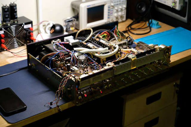

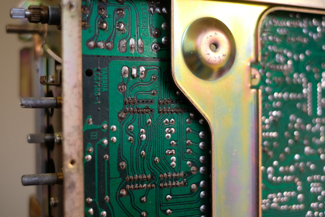

faceplate off

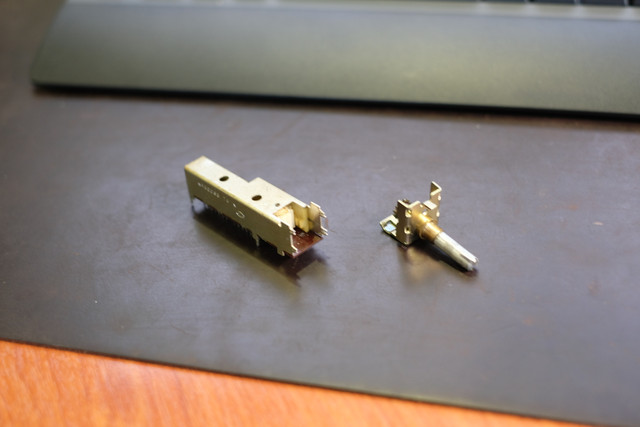

It seems I will not be able to remove the switch without completely removing the tone control board
.:thumbsdown:
I manage to remove the switch
I am not sure I will be ever able to put it back!
this is a first time for me...
the white plastic gear is damaged.
I can't fix it.
i need to find a new switch or a new tone control board.

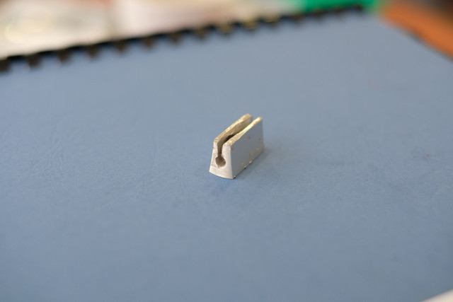

I may have a lead on a CR-800 (junk), do you know if I can take the selector switch from it?
The CR 800 paddle is probably slightly smaller, so you could switch it with the speaker selector and make it less noticeable. Maybe you could also use the record output switch in place of the input switch and just put something else there to hold a paddle.
I need to put this project on hold until I find a input selector switch or the entire tune control board.
(there is one right now on ebay, thanks @avionic, however, the seller does not ship to my location!)
I will be back!

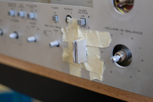

Hi @jayfree , i did as you said.
I used the record output switch in place of the input switch.
Tested, all good!
i know it is not perfect, but i do not use tape recorder anyway.

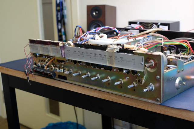

the tuner string was a nightmare to put back together!!!

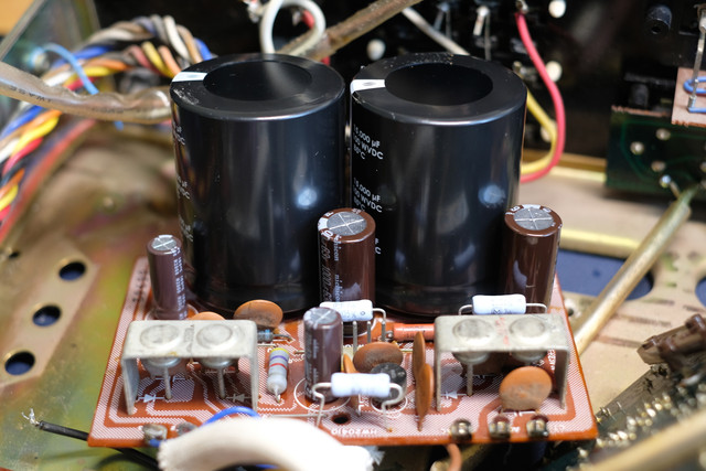

I am glad my suggestion could help you get up and running. The tuner string is the one thing I have managed to not have to deal with, except maybe partially removing it to some maintenance on something else. It's too bad you can't get some spare boards shipped to wherever you live, but if you ever need a relay or capacitor board for the power supply, I have the files to have them produced, you can have them, or the KiCad projects if you want.
