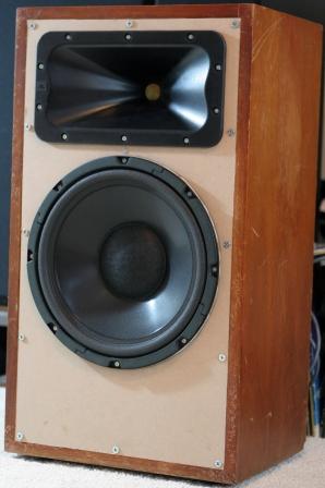

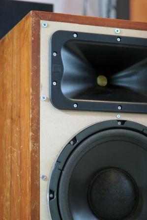

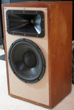

I have been working on an Econo-Wave Speaker Project for a few months (in between having a baby and working 3 jobs). Here are a few pics of the final project. The cabinets are a bit rough but will be refinished at some point.

Those look great! Which version is that? What was in that cabinet before hand? Any listening impressions?
