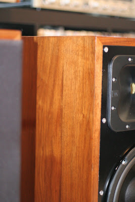

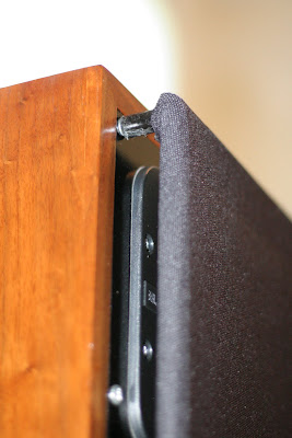

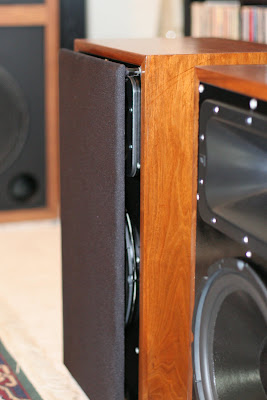

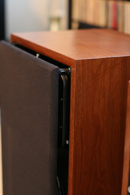

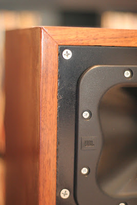

E-waver #88 UPDATE
I've been enjoying my e-waves for the past few months and have not had the time to get them to where I really wanted them. With travel, work and life I had a few irons in the fire.
Once I had a week and a half window I stripped the HD77 cabs, cherry stain, and 5 coats of sanding and poly later they look pretty good. I was not interested in taking them back to furniture grade cabs but simply wanted them to look good. I also updated to the 300-8 Dayton driver - all I can say is wow. With the cabs stuffed with closed cell and poly fill the mid range returned and the bass is there and very tight.
I hand built grill frames with 1" dowel stand-offs. They are held to the faces via rare-earth magnets.
I've been driving them with 10 watt flea tube amps and they really shine.
I'd be proud to have those in MY living room!
Nice job.... :thmbsp:
