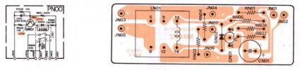

I think i found it, just want your thought on this, if you look at the photo , you can see the nine pin connector solder joints, if you start from the left and go to the fourth pin, when you follow the trace it goes to a ground at the bottom., i have no continuity from 4 to ground. I was thinking of just jumping a wire from 4 to ground. petePXL_20260609_162426831.jpg
You have not continuity because that trace from "pin 4" (actually JE05 pin 6) does not connect to anything.
Take a look at the board layout and schematic.
The trace from the connector, 4th from the left, is "6". If you trace it down to the bottom of the board it just stops.
Compare the layout to the schematic, connector JE05 in 6. It shows that it is not connected to anything.

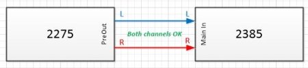

Im not sure what this tells us, i connected my 2275 to my 2385, pre out from 2275 to main in 2385, powered up 2275 then 2385, volume on 2385 50%, set 2275 to am, i get both channels no issue.

Now your latest test, using your 2275 as a Preamp and BOTH channels work OK. This still shows that the 2385 Main Amp is OK.

Now try the opposite. Connect the PreOut of the 2385 to the Main In of the 2270. I think you will see that the 2385 has a bad R channel?
It makes sense so far...
