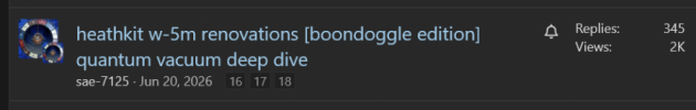

Screenshot 2026-09-03 at 18-59-08 DIY Audiokarma Home Audio Stereo Discussion Forums.png
www.audiokarma.org/forums/threads/heathkit-w-5m-renovations-boondoggle-edition-quantum-vacuum-deep-dive.1108582/
heathkit w-5m project and analysis has reached a partial conclusion, amp 1 of 2 complete with v1.0 renovation. a long story / picture book of the design and history of a 1955 foundation piece of audio gear. more than a few options available when adjusting the system for high longevity.
since the picture book is about 90% complete it should be easy to digest for those in a hurry vs waiting for an active project to be completed. every viewer/person/bot/interstellar-hacker is different on the world wide web of digital schtuff.
