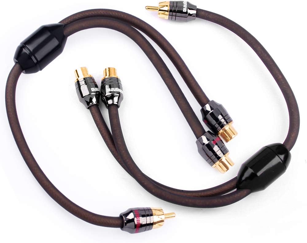

Depends on the output impedance of the pre-amp and the input impedances of the power amps. You want the total impedance of the two power together to be at least 10 times higher than the output impedance of the pre-amp. Preferably 20 times. So if you have a modern SS pre-amp with a 500 ohm or less output impedance and the total impedance of the amps is above 10,000 ohms you' d be OK. But if you have a classic tube pre-amp requiring 100,000 ohms or higher loads from the two amps you would be in deep doo-doo. The old pre-amps don't have the current capability of the newer pre-amps. If you have a modern ARC pre-amp you could be in for complications. The old 400 Fisher pre-amp with cathode followers would have no trouble at all. Just remember the 10 to 1 or preferably 20 to 1 rules.

Running a short Y cable is the same.

I use one of these for 3 of my power amps from one preamplifier ,just reverse the RCA output jacks to input.
Readily available from online for cheap or your local electronics store.

FWIW, In the past when I needed to drive 2 or more different amplifiers, whether SS or tube, from a preamp, also whether tube or SS, I usually installed what ever amount of L/R RCA jacks that was required for however many amplifiers to be driven and mounted them in a project box with common 47k (or higher) resistors connected in series between the input of the box`s RCAs to the output RCAs to provide buffering/build out isolation between the preamps output impedance & the paralleled input connected amplifiers combined input impedances..
Was especially helpful for me yrs ago when driving different amplifiers connected to different sensitivity speakers engaged at the same time and keep from any effect of adjusting one power amps input level adjustment controls from effecting another strap connected amplifier`s input levels, and of course buffered the preamps output impedance from being loaded down, as no matter the amount of amplifiers connections the preamps output was buffered by the 47k series resistors, which value is not carved in stone and could be empirically adjusted/selected for best results depending on the particular desired preamp/amps equipment connection configuration.
And since the preamps output signal levels and especially current levels is very small the resistors shouldn`t effect the overall signal throughput strength by much of a signal insertion loss..
