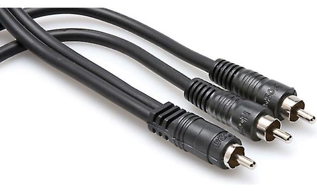

These are what I would need to connect two amps to one preamp out, correct?
The problem here is that you are going male to female. In this case you would have to connect another set of interconnects to these y cables. This is not preferable. You want the fewest amount of termination points possible. It would be best to have a male to male y cable that goes from the preamp to one amp then another single y cable from the preamp to the other amp. You eliminate 1 termination point per interconnect doing this.
So a pair of these?
Yeah, something like that. Shorter = Better.

I was doing the same when using my Mac C34V preamp, which has 3 outputs. Now that I've switched to my C22 with only one I'm splitting it's only output between my 2 amps. Impedance wise works well, and sounds great.
And the new 2M-1M cables sound great. Dare I say better then the 2F-1M connections.
