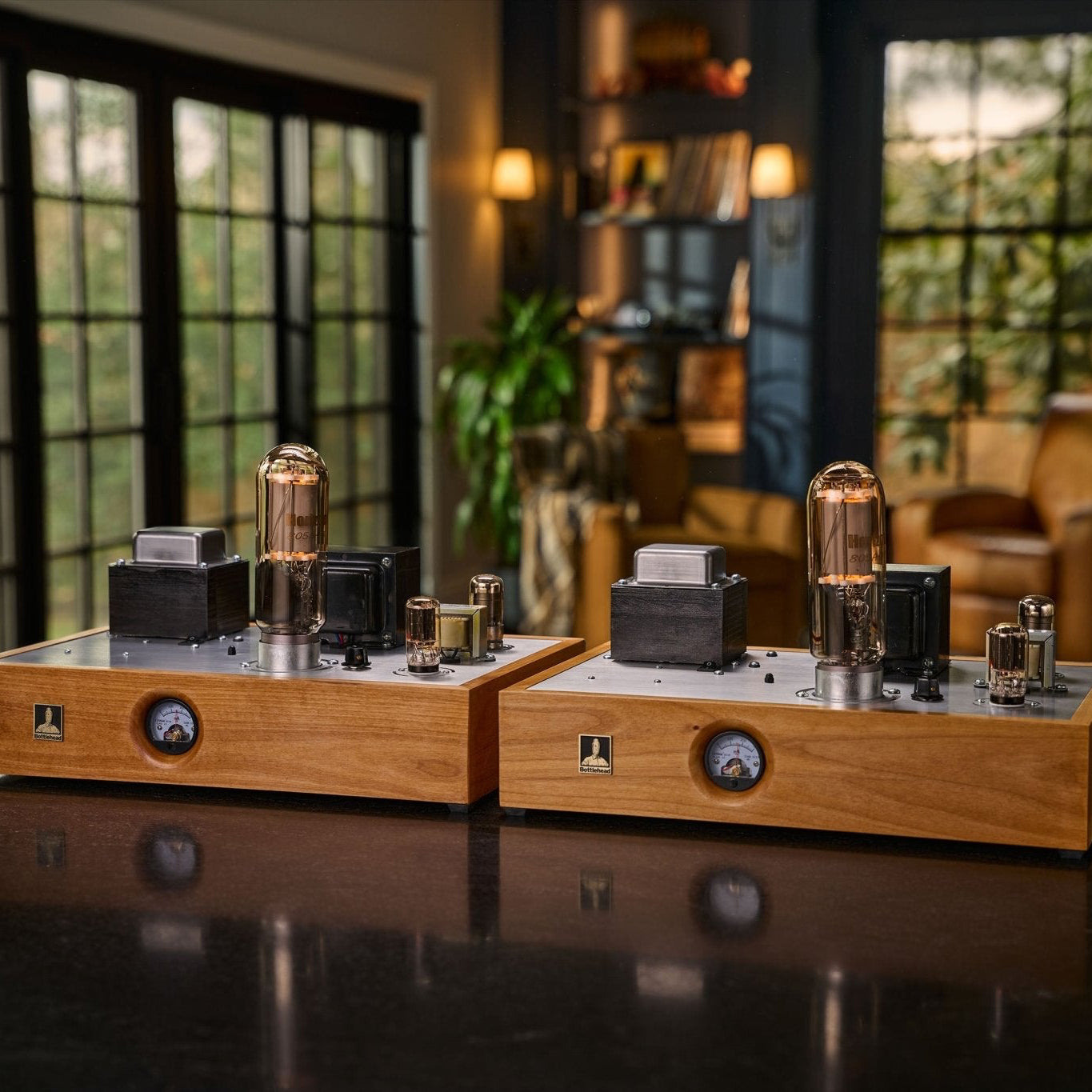

Is it just me or do the OPTs look small for a an amp with this power output?
For single ended, yea they look small at that power level. Looks about right for push-pull.
If it is, that would get rid of the DC problem and allow a smaller transformer for sure. To do that I guess you'd have to use a large plate choke to feed in the DC, and a cap to couple the AC over to the transformer? Only other way I know to do that is a resistor from B+ with the transformer coupled via a cap but that would waste a ton of power in the resistor.

You'd be buying modern ones because they're made without the plate cap. Either way, vintage or modern, they're about the same as a new-made or vintage 845 or 211, depending on the brand.
Yes, the output iron is a plate choke and a separate output transformer. The operating point of the 805A and the circuit design allow a far lower output transformer primary impedance than you'd typically find on an 805A amp, which also reduces the size requirement of the iron.
Saturation starts to happen at 31W/35Hz, so bigger iron didn't seem necessary.
You can substitute vintage 838 tubes in place of the 805A. These are functionally identical in the Paradyne.

"audiowize" is my colleague, Paul Birkeland - and the principle designer of the Paradyne. :^)
You are right, they do look too small. But the 805A in the picture obscures part of the OPT, and the choke is hidden under the chassis plate,
I designed the plate choke and output transformer. Both are built on 2" stacks of EI-125 laminations (3.75" wide by 3.125" tall) and each weighs 6 pounds, so 12 pounds per monoblock.
