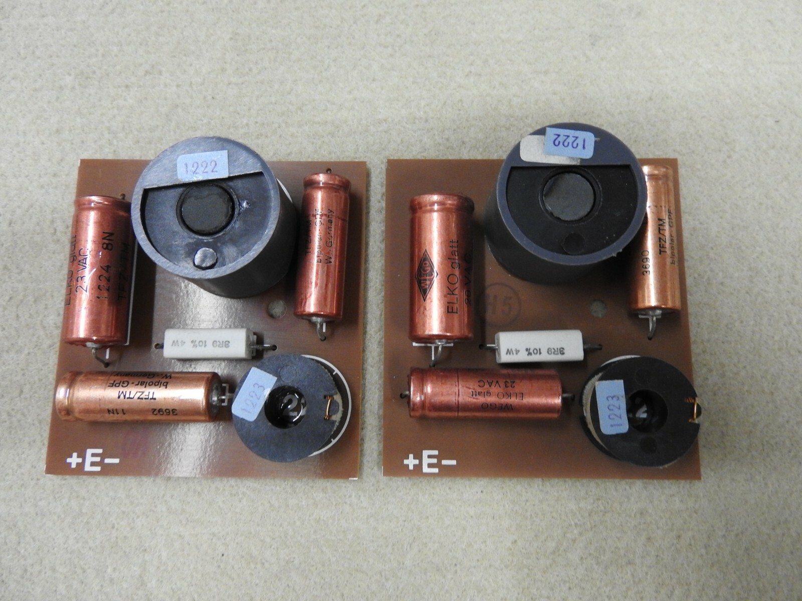

Hi everyone, I can't figure out what the value of 1224 capacitor oil is (it's on the upper left).
It's a Canton XI 270's crossover:
