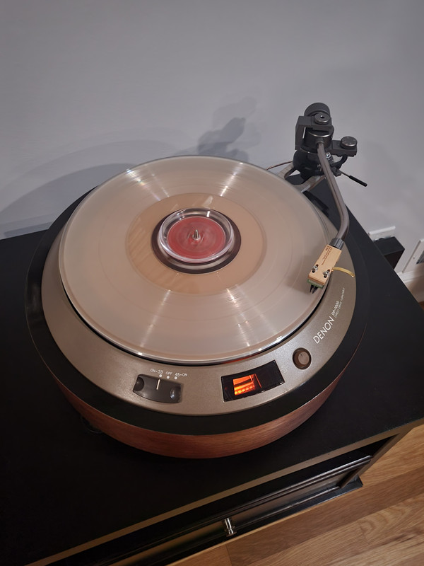

Does anyone here know whether or not the DP-80 fits in the DP-2550 plinth? I recently finished restoring one and I figured if it fits, a DP-80 or 75 motor unit would be an upgrade from the DP-2000 I have now.
I have looked around for a while now but have been unable to get a conclusive answer. I'd hate to buy a DP-80 one day and find out it won't fit.
Here's my TT:
You could download the free DP80 template on vinyl engine and take some measurements.
I found the template. Unfortunately there's no template for the DP-2000 that I can find. Does anyone have one by any chance?
From looking at the DP-80 one and my raw plinth it looks like it should fit. The DP-80 template has a smaller extra cutout in the back compared to the DP-2550 plinth but it doesn't look like that would matter?
View attachment 2769977 View attachment 2769978
I would print it to scale and put it on top of the base you have.
