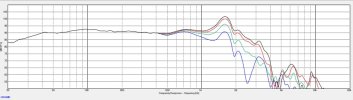

Anyway to get that CD to play nice with a DC380-8 15"
Maybe.
The graph for the DC380-8 shows a typical response "bump" right before the upper end rolloff:
This can sometimes be dealt with, by staggering the crossover points, between woofer and horn- what's known as "gapping" the crossover, so that the lowpass is at a lower frequency than the highpass. Normally, this would leave a "gap" in the response- but in this case- the woofer peak would negate that.
The Econowave crossover is effectively about 1500Hz or so. That's fine for the highpass for the horn. BUT- the woofer has to be dealt with a bit differently, to get rid of the peaking at rolloff. In this case- a second-order lowpass with a Zobel, probably about 800Hz, could work well. Though the crossover is rolling off at 12dB/oct. above 800Hz- the peaking- which looks to be roughly 12dB/oct. itself- would "cancel out" the crossover rolloff, until about 1500-1600 Hz or so- where the woofer response starts to roll off, itself. Probably close enough to blend with the E-wave horn and highpass.
In this case- a low pass section consisting of about a 3mH choke and a 12uf cap, combined with a Zobel of about 8 ohms and 50uf across the driver, SHOULD just about flatten out the response of the woofer, to about 1500Hz. Use that with the standard E-wave highpass, and you'll probably have a decent starting point for tweaking. If there needs to be a further reduction in energy from the woofer between 800 and 1600Hz- a smaller value Zobel resistor can be used (down to as low as 4.7 ohm should be fine, if it makes it sound better). Given the nature of the phase response of the combined woofer and low-pass- it might be necessary to experiment with trying the horn at both in-phase and inverted polarity, to see which one blends better.
Naturally- there's always a bit of compromise, in off-axis response on a big woofer run this high in frequency- but, I've heard some pretty darn good systems done this way, with similar 15" woofers, despite that fact...

Thanks Gordon, I can actively play with the crossover via bi-amping, and try the zobel network out. Do you think your approach is preferable to crossing the woofer lower and the tweeter a tad higher using a midrange driver as a "filler" driver" (just enough to flatten out the trough)? I have some older Jensen sealed back midranges I could play with .
A filler driver will definitely be more complicated- but, it depends on how much you're willing to tinker...
If you're bi-amping- you may not need the Zobel. The Zobel just makes a passive crossover work correctly. The woofer impedance cannot upset an active crossover, before a power amp.
You will want to make sure that the electronic crossover has the capability to provide a second-order (12dB/oct.) Linkwitz-Riley alignment (Q = 0.5).
Also, if you're using an active crossover on the high frequency drivers- you will also need an EQ, to replace the shelf filtering that the E-Wave crossover does. It effectively reduces the output of the horn below 10KHz, to effectively boost the output above 10KHz.

My d230Ti drivers arrived and I measured one on a H6512 ( then proceeded to create a crossover ).
Here's my kick-at-the-can ( & not actually owning the GRS woofers means there's quite a lot of speculation baked into this design > so use at your own peril ).
NOTE: ( the bit of purple trace ) ; This is the HF response when L2 is omitted.
- FYI, parts C2 + L2 form a PEQ boost filter ( centered at @ 12K ) with about 5db of lift ( observable in the next pic, within the "Electrical-Response" window ).
- It's an uncommon filter to find within any eWave project since it really requires that the user owns an LCR meter to measure ( & use ) the exact values required.
Here's a closer look at mostly the crossover region ( note the 3.5" requirement for offset between the 2 drivers voice-coil regions ).
The teal-colored trace is the raw response of the d230Ti on the H6512 ( windowed at around 5ms to clean up some contaminating reflections ).
- I show it to illustrate the big HF hole that required the PEQ ( boost-filter ).
- I was happy to see how quite "flat" the combo was between 2K to 5K ( typically, other drivers with this horn have more ripple in this area ).
The crossover point ( @ 1550hz is right at the lowest possible point for this driver/horn combo ).
Also, here's the .mdat file ( zipped ) so that you can play with it some in XSim ( as a learning opportunity ).
Excellent work EarlK... that's a pretty straight line! thanks for the Zip, I'll take a stab but I don't think there is anyway I am improving on that design of yours. I am glad you put a variable L Pad in there as I was going to ask how best to implement that as I wanted to install on my Ewaves.
