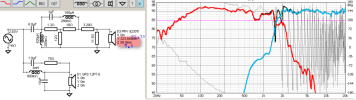

Well, since you made the effort ( to get a measurement posted before Christmas ) here's what I think you did.
index.php
I believe I see a 10R and a 2R resistor paralleled in the R6 position ) which result in a final value of @ 1.67R .
From my vantage point, it appears that you think that when resistors are paralleled, the values directly add together.
( Not so ! >> they need to be wired in series to get 12R from that pair of resistors ).
Load that 1.67R value into the prediction software and the huge notch gets produced ( centered at @ 2.5K in my simulation ) .

OK, ( continuing on with this theme ).
Here's a network evolution that extracts a bit more mid-band efficiency ( 1.5-2db > so it's pretty modest ), plus a bit more UHF over 10K.
-The purple trace is the existing projected response with the current network.
